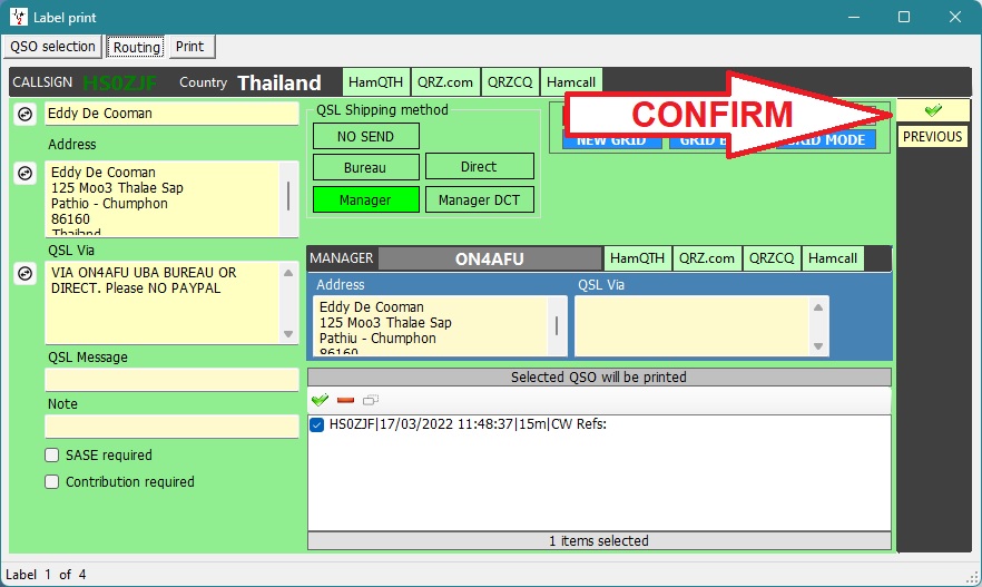

I am using version 2.20.00. After some time out of action and not having printed labels for a while, I tried to print labels. QSL Via details are not picked from QRZ.Com or from my log. When I go into Routing for a new QSO, I have noticed that something appears in the Via box and disappears immediately.
The button to the left of the Via box has a darker square round it than the other two buttons at the side of the name and address boxes (does that mean its permanently active?).
The only way that I can get QSL details is by entering the callsign into the log and accessing QRZ.Com or by scrolling down my log to find any QSL details I have previously entered.

During my final trial, having pressed the tick box on an entry, I clicked the previous box to check that I had clicked "Manager". It went back to the green screen and, much to my surprise, the QSL Mangers callsign was in the grey MANAGER box. I continued with a number of QSOs with QSL Managers. I then clicked the pdf button under the print tab. The labels had the via QSL managers details on ready for printing. Clearly, I should have done this earlier and saved myself a lot of time.

I have to ask if you clicked the confirm button for each QSO?

Yes I clicked the confirm button each time. when I then clicked the previous button, the QSL Manager callsign s were in the grey manager box. When I clicked the confirm button and went to the next QSO, the QSL Manager callsign came up instantaneously into the QSL via box but was erased when QRZ.COM was automatically accessed.

I confirm the bug.
The QSL VIA box isn't properly populated with the information inserted in the saved QSO.
Also, I have already selected the QSL shipping method (bureau, direct, manager...) in the saved QSO, but for each label I have to select it again, it should take the saved choice by default.
