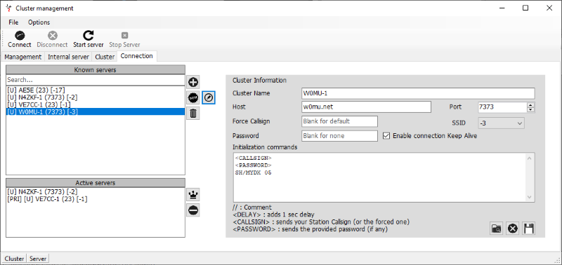

Go to: Connect / Telnet Cluster / Connection
You can edit the clusters you have chosen to operate in Log4OM V2. You can comment out the items you want and/or removed those items.
Image below is representative of a cluster I engage now and then and some active commands.
- cluster-management-medium.PNG (68.81 KiB) Viewed 1129 times

It could be just me but the editing process isn't immediately obvious. It appears that first, you must remove the cluster from the active servers list. Then edit it in the known servers window. Then once again choose it. I would have thought it was possible to do the edit by clicking on the cluster in the active servers window.
I guess the hint is the location of the icons (plus, new, write etc ) all being alongside the known servers window.

Ron,
That is correct ... you have to disconnect the connection. Remove the cluster from the lower left panel. Then you can edit that cluster, save and then add again to the lower left panel.
