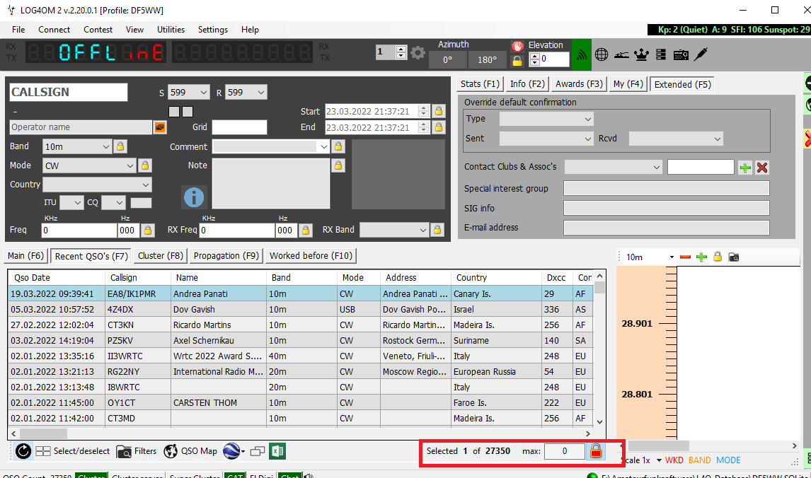

the settings are 100 to 10.000 rows and the reason ist only the slower speed if you have more contacts be displayed
in QSO manager and/or QSL Manager and in the Main UI display. But you can override in each of this windows if you
set the max. QSO count to 0 (zero) and lock it. After a refresh the complete log will be displayed.

In each window (QSL Manager, QSO Manager and the Main UI you can set (and store) to zero.
Which means that you have all your QSO´s displayed (if you want and need).
