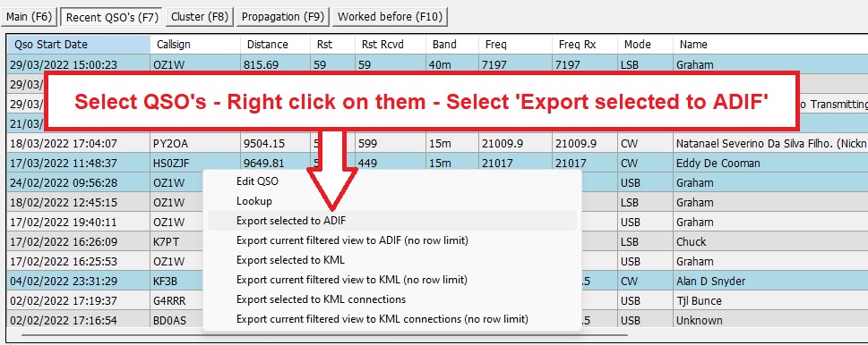

I need to create QSO lists selecting one by one and then export to an ADIF file.
I know how to make filtered lists, but I haven't been able to find a way to select one by one.
It is about making an ADIF list to print the QSLs received from the bureau.
I will appreciate any help.

In general, in Windows lists, you can use the Ctrl key to multiple select. Specifically, if you click on row in your recent QSO list, it is selected. If you click on a different row, the first is deselected and the new row selected but, if instead, you hold down the Ctrl key and then click new rows, all rows clicked on will remain selected.
After selecting the rows, do the right click and select "Export selected to ADIF"
