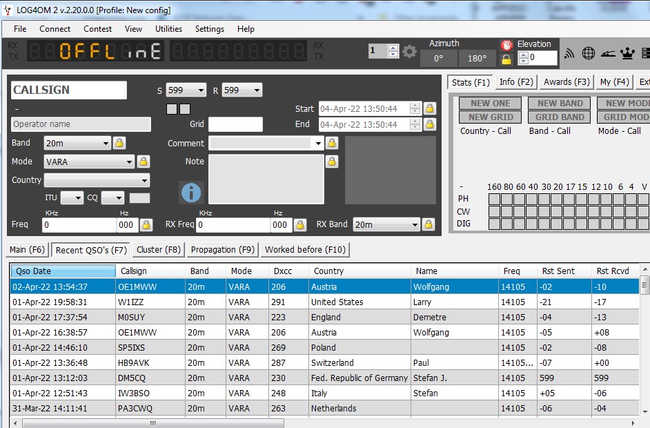

Hi I would like to ask the following, I am using your program with VarAC for logging, my problem is, as you see in the (screenshot_1) the QSOs are in MODE VARA and the reports are in form (Rst Send -02) and (Rst Rcvd -10)

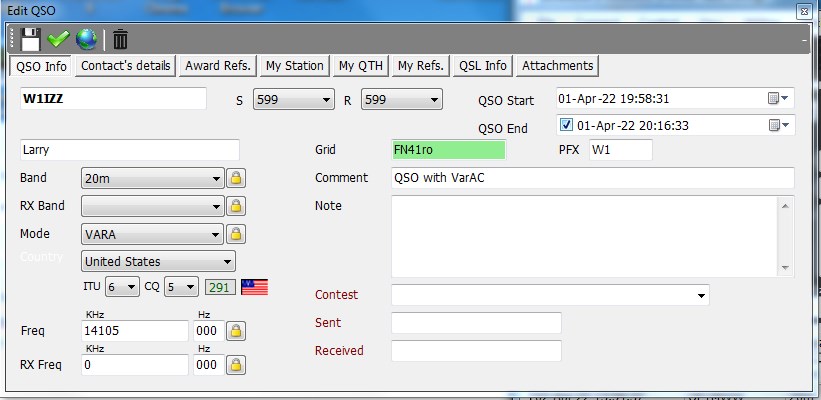

when I open a QSO in order to send to QRZ.com, HRDLOG, eQSL.cc etc (see screenshot_2) the report is in form of (S 599) (R 599) which is not correct for the specific MODE (VARA). Is it possible to change this in some future version?

You can modify the RST file as you need.
Click on: Settings / Resource Editor
Then scroll down to: rst xml
Make adjustments as you need
The edited filed will add "_user" as part of the filename so the original does not get over-written.
You will have to restart L4OM for the modified file to be recognized.

Thank you for your answer it worked perfectly
