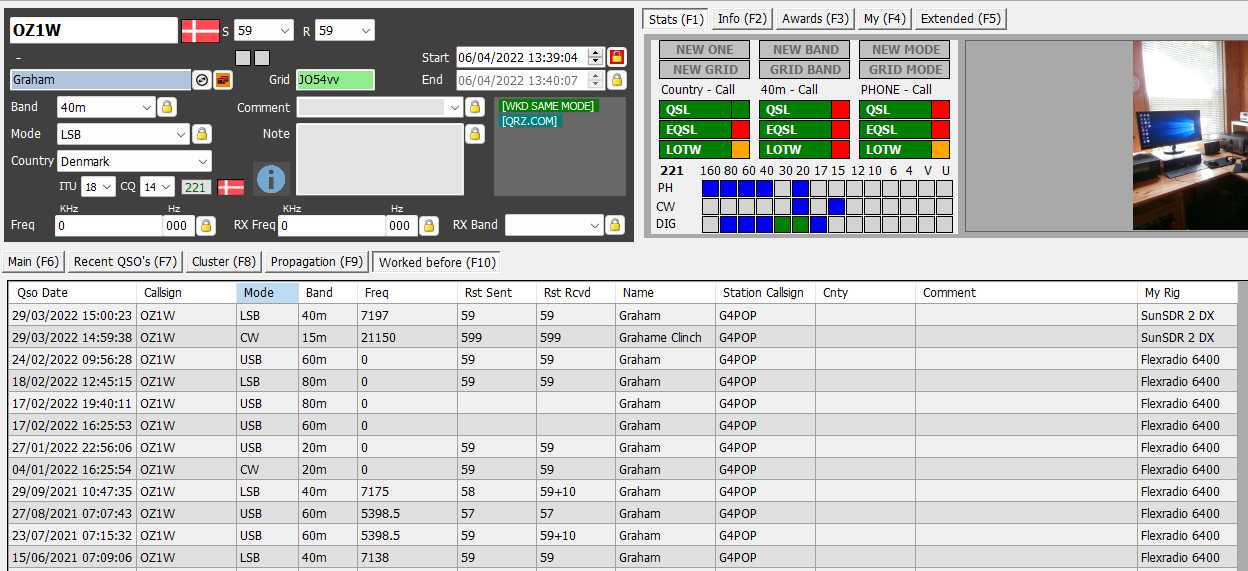

Re: Worked before with an other call
ei6kw wrote: 06 Apr 2022, 12:34
G4POP wrote: 06 Apr 2022, 07:32 Why not use a single combined logbook, I do that for my 5 call signs and providing my station call is recorded for each QSO I can filter how I wish
I am doing in that way. I am using the operator field for my various call signs.
Should also be station call sign
Owner call sign = The owner of the station, could be a club or commercial for rent remote station
Station call sign = The call announced over the air, perhaps a contest or special event call sign
Operator call sign = e.g. a contest station using the call sign C0NTEST might be operated by many different people during the 24 hour event so this is the call sign of the person sitting at the radio at the time of the QSO - Not the stations current call
You can easily see what the Station call was that you were using for the WB4 contact here
Screenshot 2022-04-06 144029.png (127.59 KiB) Viewed 1364 times
