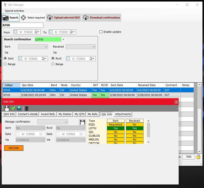

I've been trying to replicate the issues you noted in your post. I am also using the same version of L4OM that you are.
So far I can't replicate your problem.
Below is one of my tests.
Problem updating confirmations
Re: Problem updating confirmations
- qslmngr-qsoedit-medium.JPG (63.13 KiB) Viewed 2682 times

Thanks for your efforts on this. We are discussing it among the team members and will see what we can come up with. Very odd that two different machines are doing the same thing. We need to figure out the common denominator with this. As far as I know you are the only person having this issue but in all fairness many people do not use this tab.
Just want to check. Are you running screen scaling as one of your screenshots shows something in odd location?
Rich
kd0zv
(alpha team)
