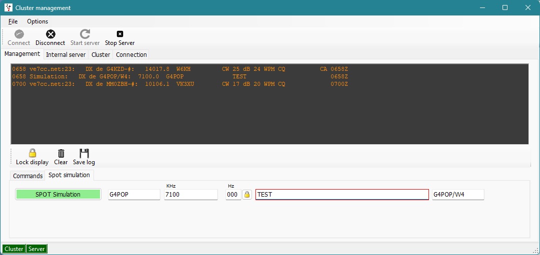

Firstly I can confirm there seems to be a glitch when sending live spots in that the suffix is dropped from the spot reporters call sign is not included, I will add this to our Mantis list.
However I found the spot simulator in the Cluster management control to work OK, see below
Screenshot 2022-04-25 080013.png (6.46 KiB) Viewed 796 times
Spot simulator.jpg (87.79 KiB) Viewed 796 times

As you read in my initial message ... I tried submitting a spot report from Cluster management to send an actual "live spot" to the reflectors. It did not work. Rather it just send AH6FX and not AH6FX/W4.
I also tried the Spot simulation as you did. It worked OK by reporting me as AH6FX/W4 but of course it is only a simulation and does not send the spot report to the reflectors.
