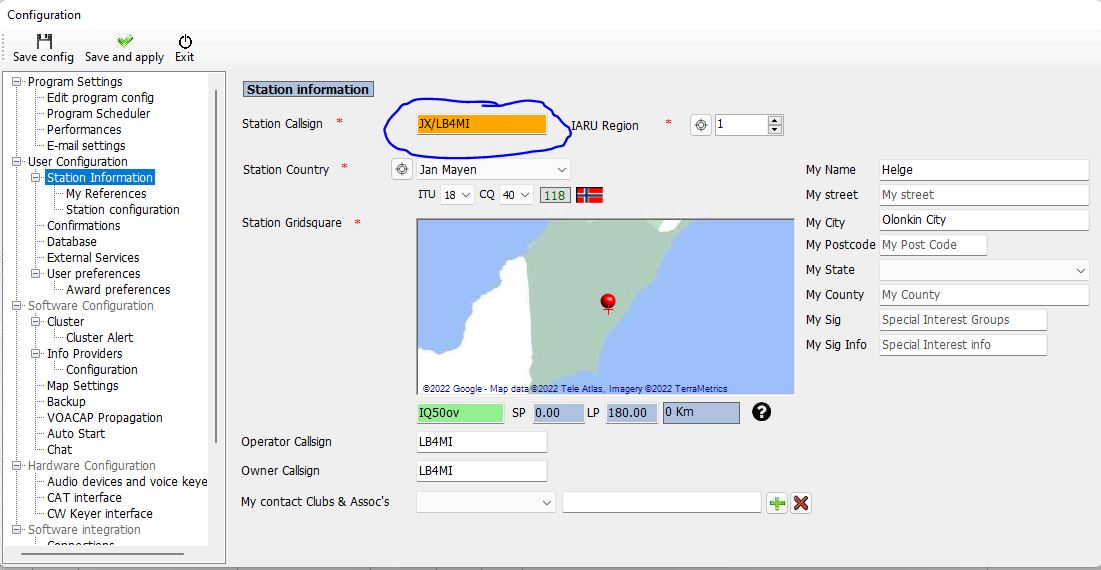

My "Station Callsign" is set correct in the "Station Configuration", and the profile is active.
However, all QSO logged are marked with LB4MI, instead of JX/LB4MI.

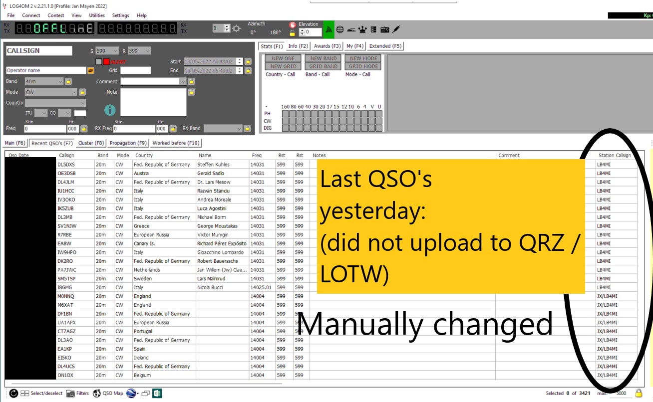

So, the problem is not my online logs, sorry if I was unclear. The reason for online logs getting trouble is that LOG4OM is not using my "Station Callsign" from configuration to the ADIF-file. And than later on, the online logs can't upload as I am uploading with LB4MI to all the online logs that are now configured with JX/LB4MI.
Here is a picture of the issue. When I register a QSO, the "Station Callsign" in my ADIF is LB4MI, while in settings it is set as JX/LB4MI. The QSOs underneath is manually changed by myself. The top QSOs are from yesterday, where I have not changed anything afterwards:

Helge,
I tried a variety of prefixes and they are all faithfully reflected in the recorded data, see below.
Please update to the latest Beta release 2.22.0.8 from https://www.log4om.com/download/
Re: "Station Callsign" not being added to log [SOLVED, user error...]
Terry,
after more invetigation, I was able to find the problem!
As my new "Subject" indicates...
I am using N1MM for my logging, and the Log4OM gets the data from N1MM.
And, in N1MM i found my callsign being LB4MI only, without JX/....
I didn't think of this, that the "third party" software overrides local Log4OM settings, but I guess now that make sense.
Thanks for your help anyway,
73 from Jan Mayen
73 from Jan Mayen
LB4MI wrote: 12 May 2022, 07:33 Terry,
73 from Jan Mayen
What actually happens is we do not modify incoming data because we have to assume that is what the user is happy with like Name = Bill but update it to the QRZ data which is Name = William Alloush's Mahoney Smith Junior
So similarly we must assume the Station call is correct
