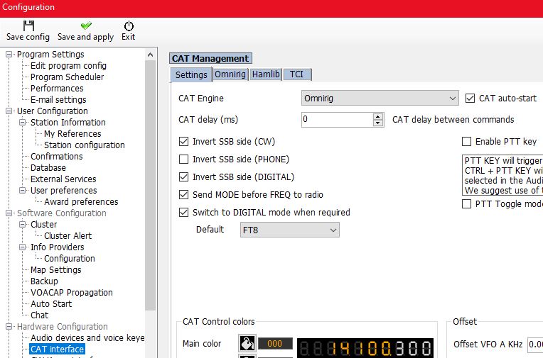

Anyway ... with Omnirig there are two INI files to choose from. Likely some minor tweaks in the commands for each of those INI files. You could possibly select the one you are not using and give it a try.
Also ... there are tic boxes in the Configuration / CAT tab where you can make some optional changes about what order commands are sent from Log4OM to the rig.
Check the Config / CAT panel and the tic box about switching to Digital and you also might have RTTY selected in the dropdown instead of FT8.
Images of the two FT2K OmniRig INI files that are in the current database from OmniRig and the location in Log4OM for CAT options.

I looked at the Omnirig choice and noticed there are actually four choices. I tried them all and got the same result except one of the choices set mode to PKT whereas the remaining three selections set mode to RTTY.
I revisited the Configuration / CAT like you suggested and ticked boxes, Invert SSB side (Digital) and box Send MODE before FREQ to radio. No change; CAT still set rig to RTTY.
