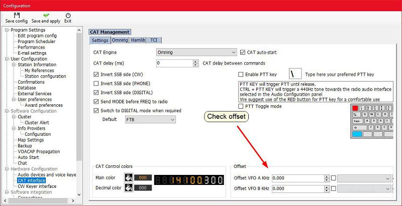

Mario,
Check your Configuration / CAT setup. It is possible that you have turned on the offset.

I have the same issue on the latest stable version Log4OM with FT-991A. Sometimes is frequency shifted on TRX after double-click in cluster. Offset in CAT configuration is turned off.

Try selecting 'Send mode before frequency to radio' in settings/program config/CAT Interface menu

Thank you, everything is working properly for now.
