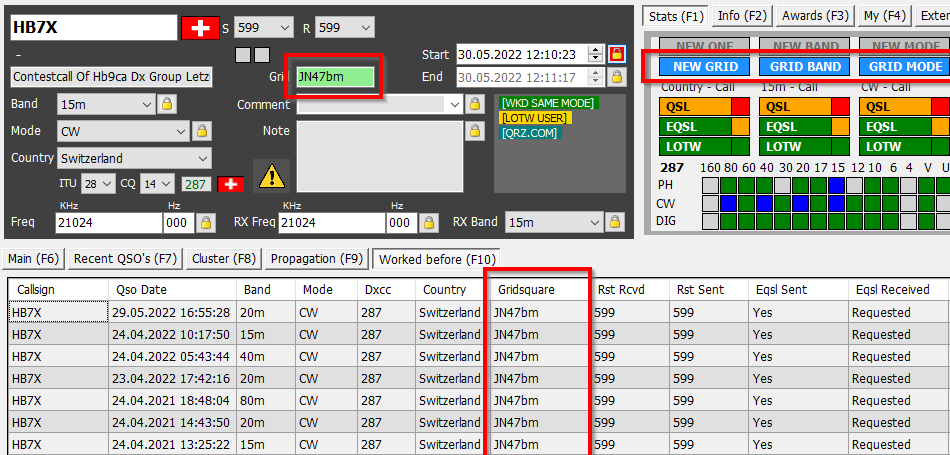

Hello All,
Whatever I do, I see always all the Grid related Fields on the Main UI as blue, even when i enter a callsign which i worked several times before on thos particular band.
Goal:
When I enter a 4 or 6 Digit Grid square I'd, like to see correct statistics (based on 4 Character Grid i.e. JN65) like the ones for DXCC, which work perfectly well.
Means I'd like to see wether a Grid is New, New for the actual Band or new for the actual Mode.
What I am missing or doing the wrong way ?
Thanks for any help.
2022-05-30 14_11_17-LOG4OM 2 v.2.21.1.0 [Profile_ HB9DBM ALL].png (56.87 KiB) Viewed 1829 times
Mark, HB9DBM

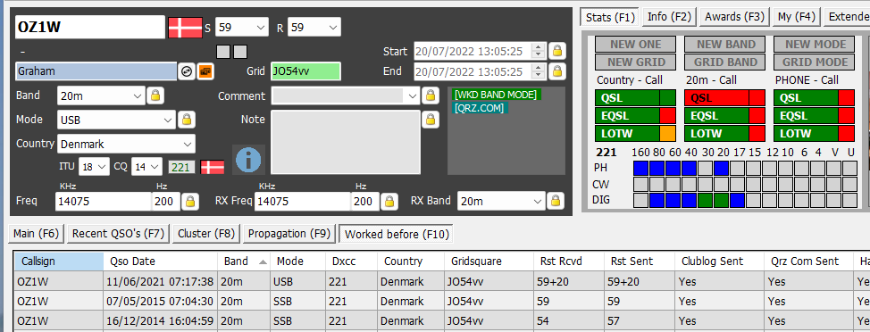

ON6AB wrote: 09 Jun 2022, 09:33 The GRID boxes never change colour. Are they supposed to?
Yes they do change see images below
I don't understand when you say "you should watch the top row".
As I see it, the top row says NEW ONE / NEW BAND / NEW MODE
Nothing to do with grids...
They change colour according to the worked status of the grid reference entered in the input window - If you worked the grid on band or mode they stay Grey if you have not they change to Orange
If you have NEVER worked the grid NEW ONE changes from Grey to Red
Also on page 34 of the manual, there is no mention about GRIDS
As I stated "not with colour coding following the convention depicted on page 34>>> of our user guide"
Are the squares on the second row, namely NEW GRID / GRID BAND / GRID MODE supposed to ever change their (blue) colour?
Yes they do change colour as in my examples below.
I have worked OZ1W on the band and mode in that grid square - so all GRID indicators are Grey

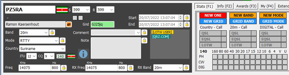

Conversely I have never worked DXCC PZ5 Suriname so clearly I cannot have worked any grid in that country on any band or mode so the GRID indicators tell me that its a NEW ONE for the GRID, BAND and MODE
