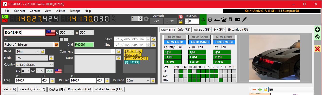

Re: Showing Wrong Country
Bob,
I don't believe that is the issue. I verified my "country.xml" file (you mis-typed the filename) and I also have the same values as you have noted.
I then entered your call sign into the Main UI and got all proper data. See image below.
I'm going to refer you back to my post above about how you have things set up in the Info Providers. I do note that you are a QRZ 'xml' subscriber so have the proper API data feed for QRZ lookups.
Try the Info Provider Configuration and I think you might resolve the hiccup.
In my Info Provider Configuration I have as Priority 1 set for ExternalSource. I also have QRZ chosen as my Primary site for the External Lookups.
If I completely turn off QRZ and/or HamQTH and use either Clublog and/or Country data sources I will get the Guantanamo Bay data for your callsign.
So ... make sure you have QRZ and/or HamQTH turned on and your should then be in good shape.
I'll ask again: What version of Log4OM V2 are you using? That information is in the top left banner/bar of the Main UI.
