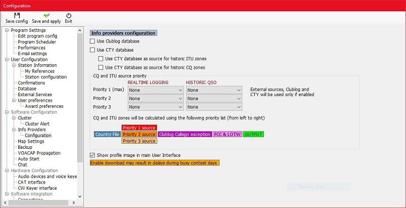

Re: Bogus grid squares added automatically
Leandro,
Tnx very much for your testing and input. Synchs up with what some of us on the Alpha Team have been noting. However with no Info Providers being selected/enabled you should not be seeing any grid or CQ/ITU data.
I also did some refresh tests with QRZ & HamQTH "disabled". I also made sure that Clublog and CTY d/b's were not enabled.
I then entered a callsign in the Main UI and absolutely no data showed up.
I also then saved that callsign and there was not any data (grid, CQ or ITU) saved with the call.
I had no active connections from any FTxx APPs.
My settings for this test are in images below.
- InfoProvider-medium.JPG (51.48 KiB) Viewed 3958 times
- InfoProviderConfig-medium.JPG (55.25 KiB) Viewed 3958 times
Further testing with my configuration noted above ...
Shows that the 'middle of the region/country' grid square shows up with using the CTY d/b for the Historic lookups when I have QRZ and HamQTH disabled.
When using CTY in the Real Time lookup no data appears.
One additional question: Is your access to QRZ.com a "paid for" (at least) XML access?

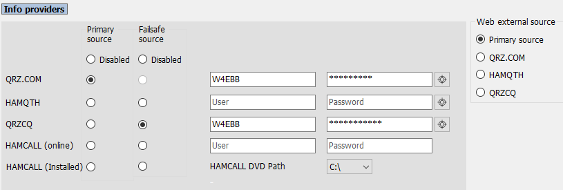

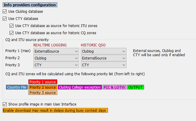

Nolan and others,
I came across this thread because recently I discovered an issue with incorrect grids. I think things may go wrong when the contact does not enter a grid.
So, not sure I am understanding everything I am including two snips of my info providers and info configuration to see if my settings make me susceptible to bogus grids as posted in this thread.
I would appreciate your feedback!
Charlie
W4EBB
Charlie
W4EBB
- infoproviders.PNG (16.85 KiB) Viewed 3857 times
- iinfoconfig.PNG (21.46 KiB) Viewed 3857 times
Where no grid is available from external sources or software Log4om uses a grid for the centre of the country it's not a bogus grid and is by design and has been so since the inception of Log4om
It's up to the user if they want to turn off use of the CTY file
