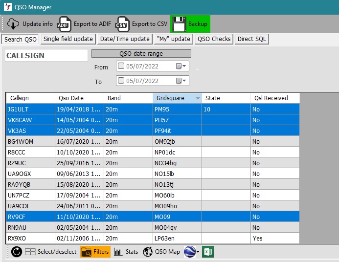

In EXCEL sort by Gridsquare and then look to see what squares (6 digit) have multiply QSO's
I had approximately 35 Squares showing as many as 100 QSO's but some only had as low as 5, (any less I didn't worry about)

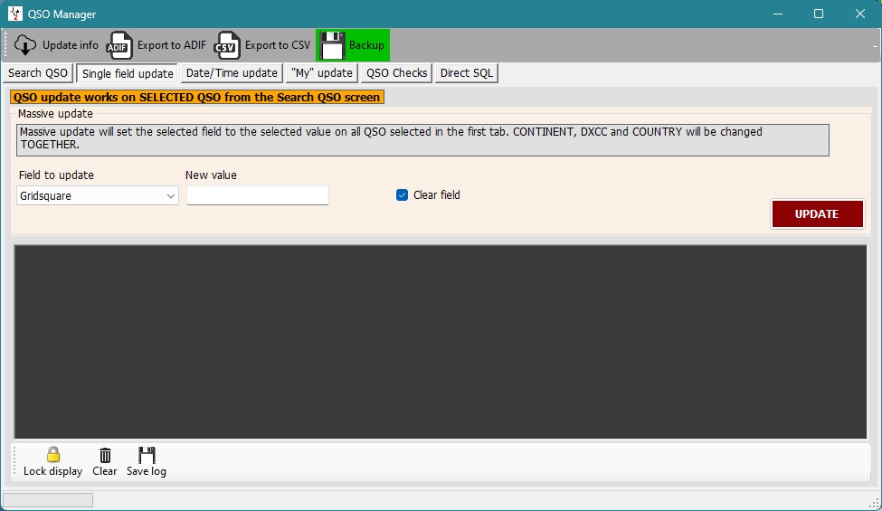

c. Select the 'Single field update' tab and in 'Field to update' select 'Gridsquare' then check the 'Clear field' check box followed by 'Update' this empties all the selected grid square fields.

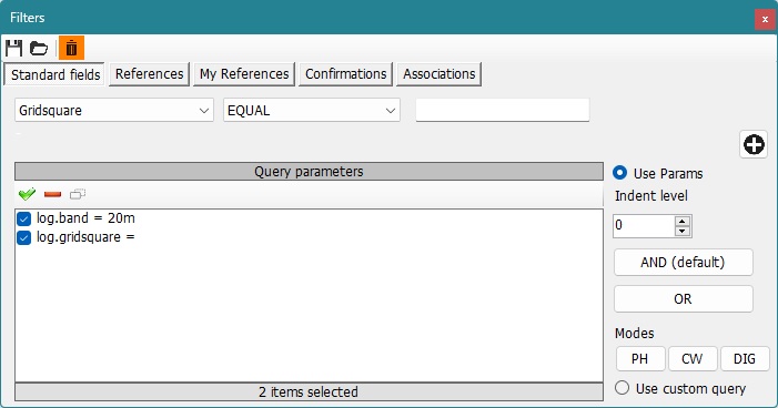

d. in the 'Search tab' select all QSO's with an empty grid square either manually or by using a filter 'Gridsquare equal to' and leave the data field empty, that searches for all Grid fields where there is nothing in the field. Press the 'Select all' button at bottom.

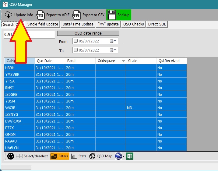

e. Now select 'Update info' on top tool bar of the QSO manager to update those selected
Now your left with just a couple to update manually.
