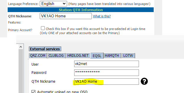

Are there any other suggestions as to why this error occurs? I have tried different nickname names and always made them match by copy and paste.

same - I've change it to lots of different but matching names with no luck

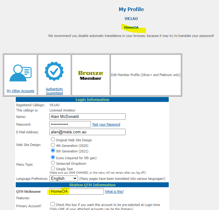

Re: APP_EQSL_QTH_NICKNAME?
When you login to eqsl via the web site and look at your account/profile what does it show as your nickname there, particularly upper and lower case and punctuation?
Try changing it on the web and replicating it in Log4OM

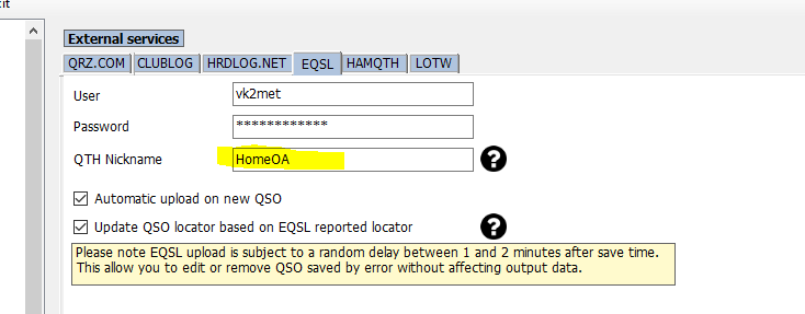

I have changed it both places - one then the other then reverse.
So this is what I currently see and it's the same in Log4OM

So you should use HomeOA as nickname in Log4OM making sure that you use the capital (Upper case) letters exactly as in eQSL
Also try your call sign (eQSL User name in Log4OM) in all capitals

I just noticed that your call sign in Log4OM does not match that shown in eQSL - They must match

The call and nickname in eqsl must match the user name and nickname entered in Log4OM external services
If you have different passwords for your eqsl accounts be sure to use the correct one
With your call sign be careful about using an 'O' and not a zero
