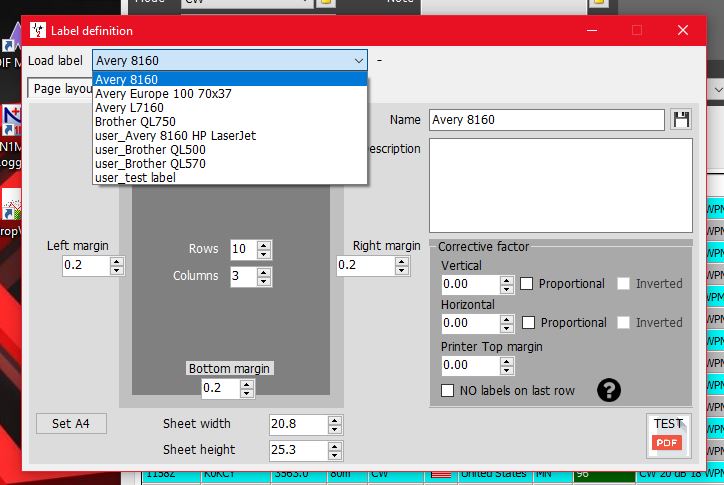

Look at Page 114 for Label Design. You can rename the label name with the tweaks you have to make for your printer arrangement and those templates will be saved with the username extension for future use.
I've included a screen clip of the various templates I've made over time and each has their own filename.
Terry & Lele have provided basic templates that are easily adjustable to match each user's configuration. Trying to provide precise templates for each possibility would be close to impossible.

If you are in the Label Definition routine and you Load a Label either what is provided as default or one you have modified and now has a "user_" prefix on it. Once loaded and you tap the TEST PDF button (lower right corner of Label Definition window) does not your PDF viewer open with some text on a page?
My confusion is in your comment above where you say "I get to the PDF and nothing happens, will not bring up the PDF to print."
Does your PDF viewer open or not? This is just a verification that your PDF viewer is operating OK.
Also when in the Label Print routine when you have gone through the QSO Selection and Routing tabs and are now on the Print tab. Do you already have QSOs listed in the Step 4: QSO Update area? If there are already QSOs in that area when you tap the Step 3: Print button your PDF viewer won't open and show the selected QSOs/labels you are wanting to print.
If that is the case tap the "Reset PRINTED status" button. It will clear out the QSOs in the Step 4 window and if you then again tap the Step 3: Print button your PDF viewer should open with the labels you are wanting to print.
