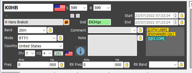

BEFORE TABBING FROM CALL FIELD
B4 Tab.png (23.24 KiB) Viewed 1111 times

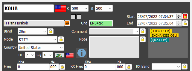

AFTER TABBING FROM FIELD
After Tab.png (22.29 KiB) Viewed 1111 times
