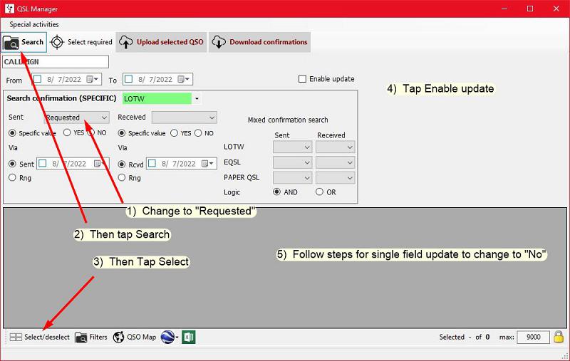

Fred,
When you open QSL Manager and have selected LOTW I'm guessing the default value in the "sent" (drop-down) box is "No".
Change that value to Requested via the drop-down and then tap the Search button.
That should then cause all the LOTW Q's you have saved to appear.
Follow Terry's steps ... I've attached an image from QSL Manager and steps to get the "Requested" Q's to appear so you can then make the change from 'Requested' to 'No'.

Re: Update Selected QSL Confirmations
Nolan,
Your picture is fully clear to me, thanks!
Managed to change them all!
Since the number of changes is huge, I optionally used the Date “From” and “To” selection located
under the field “Callsign” to limit the range for a controlled update sequence.
I wish this kind of pictures are in the LOG4OM manual, it will better explain how to use the program.
The manual is partly missing some essential step by step information.
73, Fred - PA3BZT
