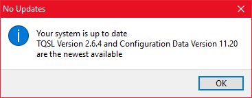

If it continues to hang up it is likely due to you not using the most current version of Log4OM: v2.23.0.0 And (very important) the most current version of TQSL.
Screen clip below shows the current TQSL version.

I do have the latest TQSL and LOG4OM2 as you indicated
