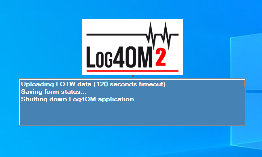

Log4OM will not shut down. I have attached a screen shot of the stopped shutdown window. The only way I can completely shutdown the program is to go to the Task Manager and END the task.
Help please.

Steve,
Take a look at your log file ... found at: Help / Open log file
It will likely give you a clue as to error encountered when closing Log4OM.
Also ... go into: Settings / Program Configuration / External Services / LOTW ... and untic the box for Automatic upload on application close.
This will stop the "Auto Upload" of your LOTW Q's when Log4OM closes.

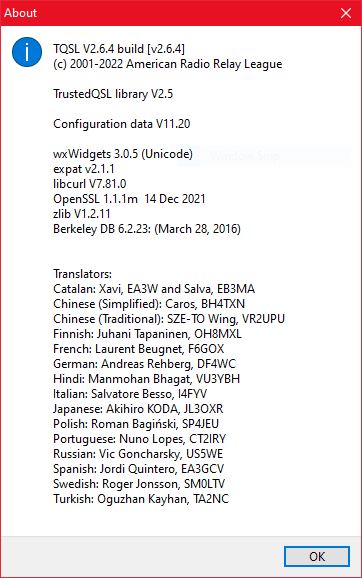

Check to make sure that you have the most current version of TQSL installed on your computer. I've attached a screen clip of the most current version that I have on my PC.

I'm going to guess that when you turn off LOTW Auto Upload that Log4OM will close without too much delay.
Take those steps and and let me know how you get on.

Thank you for the help.
Success!! Un-checking 'Automatic ... close' seems to have solved the problem.
