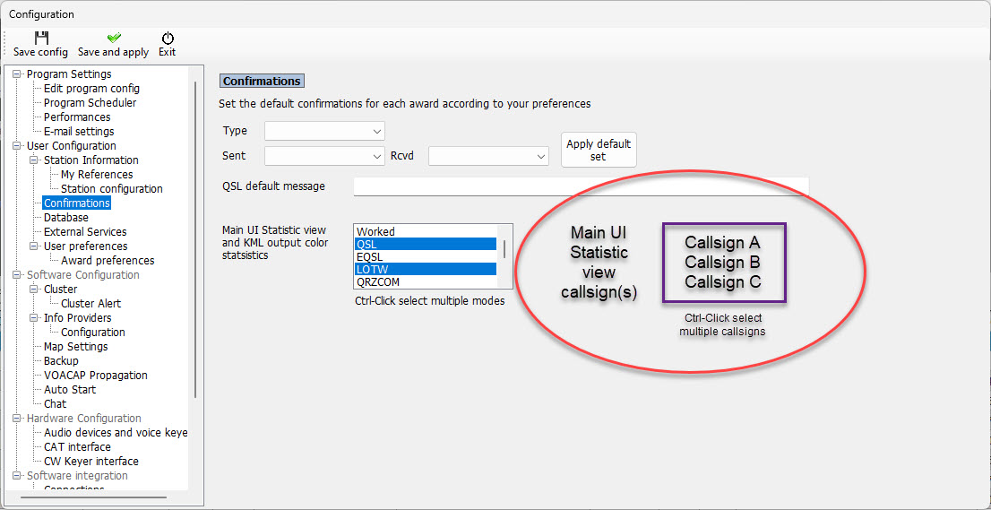

Re: Question about merged logs
Dear Helge,
Just to clarify as follows
The confirmation data shown in the main UI below is calculated on the complete database for all of your call signs
Frame 1 new.jpg (17.89 KiB) Viewed 1603 times

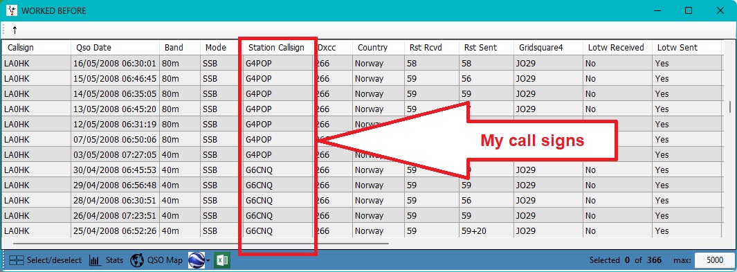

The history displayed in the worked before screens are calculated on the complete database and includes all of your call signs
If you need to see confirmation and WB4 status displayed by your station call signs you will need to use a separate database for each of your call signs
Frame 2.jpg (171.11 KiB) Viewed 1603 times

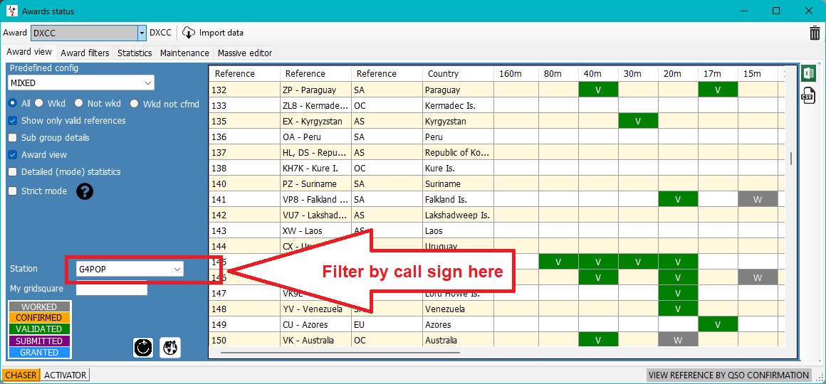

However when viewing Award statistics, label print, QSL manager and QSO manager etc you can filter by call sign
Frame 3.jpg (200.04 KiB) Viewed 1603 times
