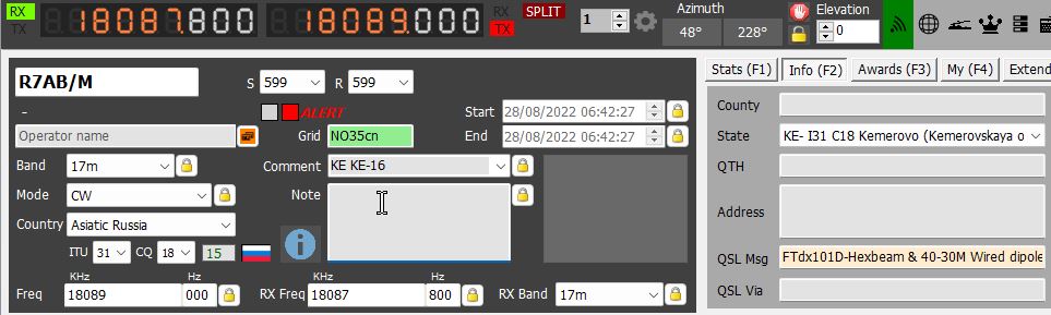

I do not understand :
1) In the settings I confirm "Overwrite user gridsquare in main UI
2) I contact R7AB/M who is on a mobile in "Asian Russia", so I type his call R7AB/M but I do not validate;
I don't use the "Tab" key
3) I click on Country to change "European Russia" with "Asian Russia"
4) I change the Grid to NO35cn
5) I change the CQ and ITU zones to CQ 18 and ITU 31
6) I validate "State (F2)" with "Kemerovskaya Oblast"
7) and I validate with "Enter"
Log4OM ignores my changes
The Grid reverts to KN95 (which is the base locator of R7AB) and does not take the typed locator (NO35cn)
The CQ and ITU zones return to their initial values CQ16 and ITU20
I do not understand what to do that in the Log Log4OM take into account what I typed and not what is by default
I definitely missed something
If you have any ideas to guide me
I do not understand
I do not understand

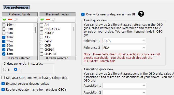

there was a small issue on gridsquare that i've fixed.
The flag works that way:
Flag set = external source will OVERWRITE user settings during QSO external data parsing phase
Flag NOT set = external source will NOT overwrite a VALID gridsquare set by user
There is a glitch on the field description (?) i'm fixing
All other fields are overwritten during external data scan, nothing excluded (except grid as indicated above)
System cannot understand all potential situations and usage patterns, the rule is "overwrite everything with certified information".
So, in that case, the right way to work is to perform an external source scan and THEN update fields on the user interface that needs to be fixed/amended. If the counterpart reports a gridsquare on radio (it's unlikely reporting a CQ zone during a qso...) the gridsquare is kept if the flag in the user preferences is NOT checked.
Packing new alpha version for internal tests, then i'll release as a beta

I still have the same problem, that is to say that if I change for example the Country in the user interface and I validate the QSO, well Log4OM absolutely does not take into account my changes in the UI
For example the call R7AB/P
If I type R7AB/P in the Call field, by default Log4OM selects "Asian Russia" but it is portable in "European Russia"
So I change the country to "European Russia" and I validate the QSO
Well Log4OM ignores my change and logs me "Asian Russia"
it is of course the same thing if I change the value of the ITU zone for example I change the CQ zone from 20 to 19 and I validate and Log4OM still does not take it into account and logs the QSO with the ITU zone 20 which is default
It's still annoying that Log4OM does not quite simply log what we have selected in the UI, I have to take a lot of QSOs because I had not paid attention to it before
Lele tells me that there is a flag to validate but I don't see this flag in version V 2.24.0.0?
Where is the flag located please?
