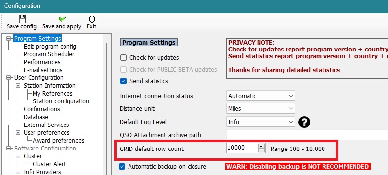

Now I am using defaulT SQLlite, coming to 5000 QSOs (4980)..... waiting for see. In log, shows only 5000. I changed to 10000, but back to 5000.
User guide describes how to set the default number of QSO's displayed, this is not the max number of QSO's in the database that is unlimited
