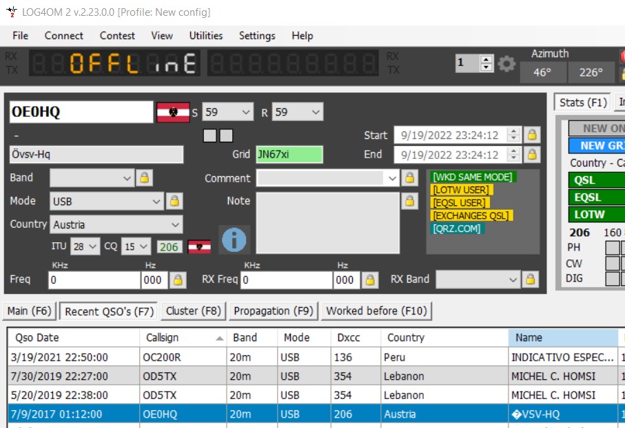

I am considering using Log4OM and have a question regarding accented characters.
I have imported .adi files from my current logging software. I have confirmed that the .adi files properly display accented charaters in MS Notepad using Windows 10. This is an example of an address: "Industriezentrum NÖ-Süd, Straße"
After importing the .adi file, the Log4OM grid displays this address differently and the characters export looking like this: "Industriezentrum N�-S�d, Stra�e"
However, when I look at the station name it is represented correctly when Log4OM returns the QRZ lookup data: "Övsv-Hq"
I have searched for settings that might control which character page to use and I have searched this forum, but I cannot find a solution. Can someone tell me what I might be doing wrong?

I entered a new contact with the same call sign manually. The address has accented characters imported from QRZ. The new record displays just fine in the data grid. So, the issue is with imported ADIF records from my logging software.
I currently use XMLog and the exported ADIF files appear to display just fine in Notepad. This seems to suggest the export is suitable for import. However, I am unable to guarantee the export is in UTF-8.
If XMLog doesn't export in UTF-8, does anyone have a suggestion for converting the file so the import reads it correctly?

First, I want to thank you for responding. While it might not seem like it, your suggestions were helpful in leading me to a solution. I ran across some stack overflow pages in my search as well. Ultimately, I found I can load the ADIF from XMLog into Notepad and "Save As" from there to a UTF-8 format. That allowed me to import it into Log4OM without issue.
