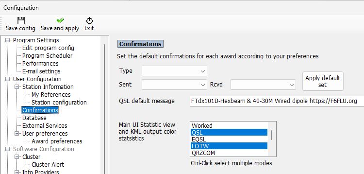

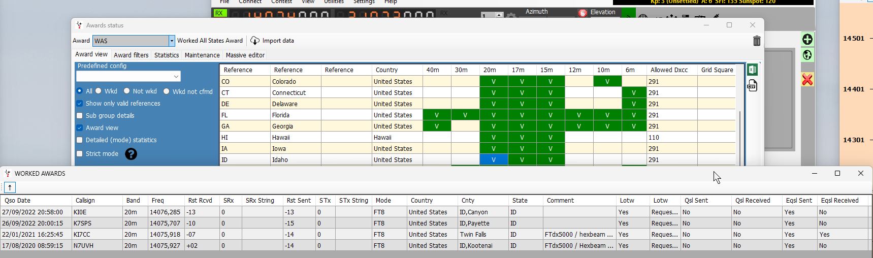

I can't figure out what to do to fix this problem.
If I look at the WAS Award only on 20M in FT8 mode I see that Idaho is validated,
but if I look at the details of the QSOs made in FT8 with Idaho I have none validated (I have chosen that a QSO is validated if I have the QSL LOTW or the QSL Paper).
2022-09-27 23_11_45-WORKED AWARDS.jpg (155.74 KiB) Viewed 687 times
2022-09-27 23_12_10-Configuration.jpg (47.39 KiB) Viewed 687 times
Which is not the case here.
So why is Log4OM telling me that Idaho is validated?

Re: Problem with the WAS Award
Read the information to the left of the QSL selection, that setting only controls the Main UI stats and KML colours
Your actual status of validated in awards is either by a LOTW match OR a QSL confirmation validated by a card checker
Post by F6FLU »
Thank you Terry but as you can see on my screenshot I have no LOTW or QSL card validation that's why I'm asking this question ...
Dan
LOTW shows Yes in your screenshot so it has been confirmed
Post by F6FLU »
Hi Terry
No the first LOTW is LOTW Sent = YES the second column is LOTW received = NO
but it doesn't matter, I'll do it again, it was just to understand
F6FLU wrote: 28 Sep 2022, 09:52 Hi Terry
It only needs one yes for rhe country to be marked as verified
Post by F6FLU »
G4POP wrote: 28 Sep 2022, 12:22
a yes in field "LOTW received" I guess but not here...
But surely that is the LOTW received field because the next field to the right shows 'Requested' so I assume that's the LOTW sent field
