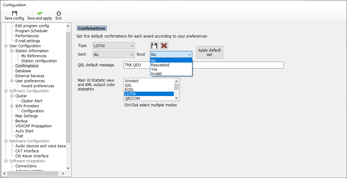

Ihave a problem.. ;) ..i constatated that by closingdown Log4omV2 that it dont update automatic my qso's to LOTW.
Selected manualy the qso's and upload them to LOTW is no problem...
yes yes last version of TQSL running ;) see my settings..
Greetings
Re: Update to lotw automatic bij closingdown
In your case LotW will only update if Upload flag is setted to "Requested". Normally we have the flag settes to "No". Change the flag and try again.
Or set it to Requested.
