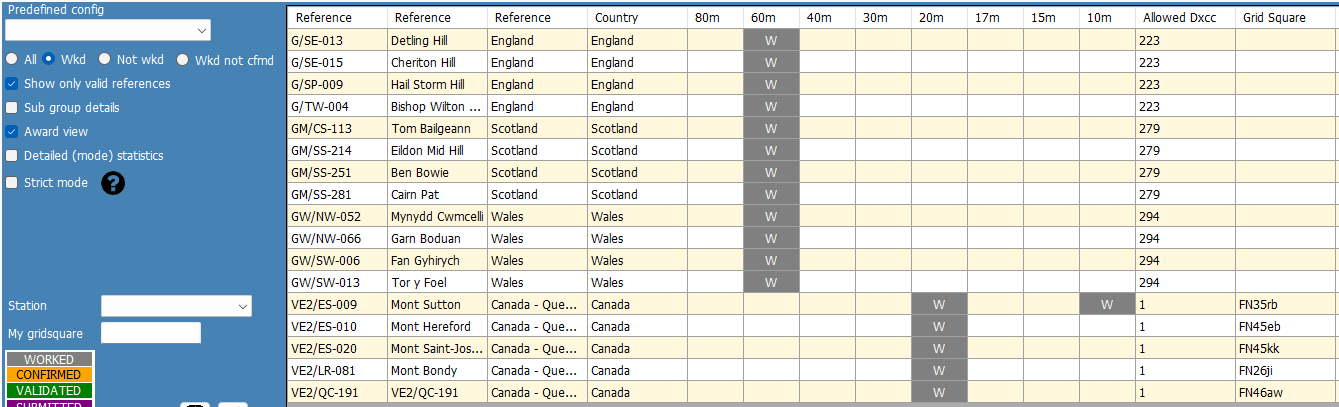

Please see the included screen capture.
As a new Log4OM user, I imported my contacts from an ADIF file exported from another logging application.
I have 5 SOTA QSO's in Quebec Canada with these references:
VE2/ES-009, VE2/ES-010, VE2/ES-020, VE2/LR-081, VE2/QC-191
In the Award Status UI, these QSO's have a long list of comma separated dxcc codes in the "Allowed Dcxx" field. The "Country" field is blank.
Three other Canadian references right below them have 1 in the "Allowed Dcxx" field and the "Country" field has Canada.
Is the long list of DXCC normal? If not, can it be fixed?

Normally would be out of view to right if you had the statistics matrix columns at the correct width, try widening the mode columns
What version of Log4OM are you using - help/about
Using same SOTA ref it does not show multiple DXCC's here, see below
Screenshot 2022-10-21 162514.png (2.87 KiB) Viewed 1511 times

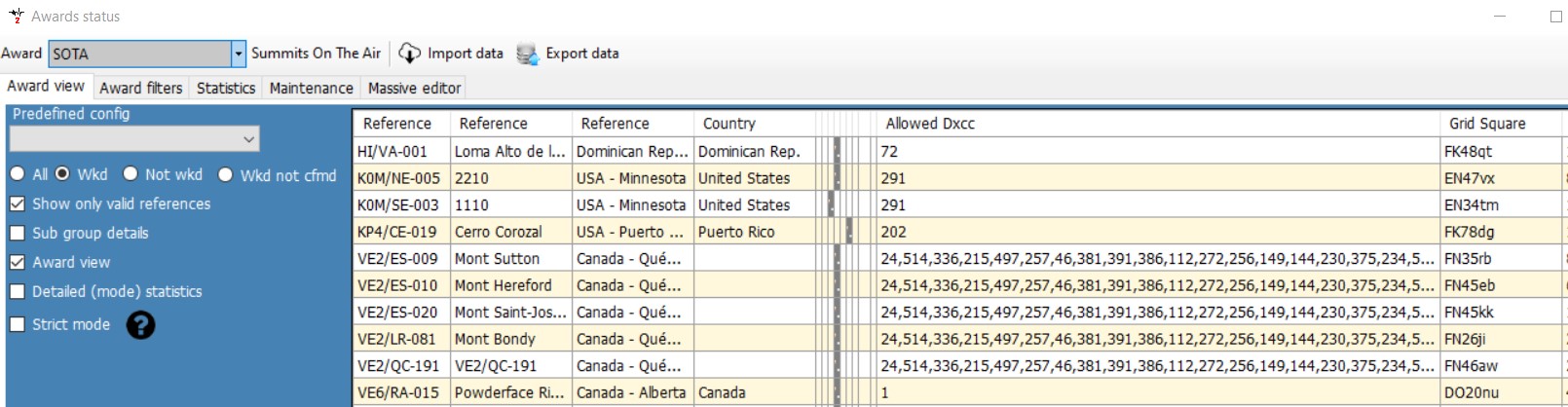

I deliberately narrowed the band columns to fit the screen capture into the post. I wanted to show the Allowed Dxcc column with the comma separated dxcc zones. Those 5 records have a few dozen dxcc zones in that field. I would expect them to have only dxcc zone 1 like the other Canadian QSO's.
It appears there is something wrong with those 5 records, but I cannot figure it out. I don't know if those particular SOTA references are actually allowed in all those zones or not?

Well I am baffled because I import the two ADIF files that you sent me without issues and you can see the result below.
SOTA IMPORT.png (55.99 KiB) Viewed 1488 times
You still have not stated exactly what version number of Log4OM your using - See help/about
So edit the DXCC field either in the QSO manager or individually in the recent QSO's grid and the issue will be resolved
