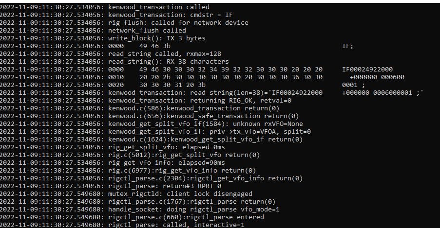

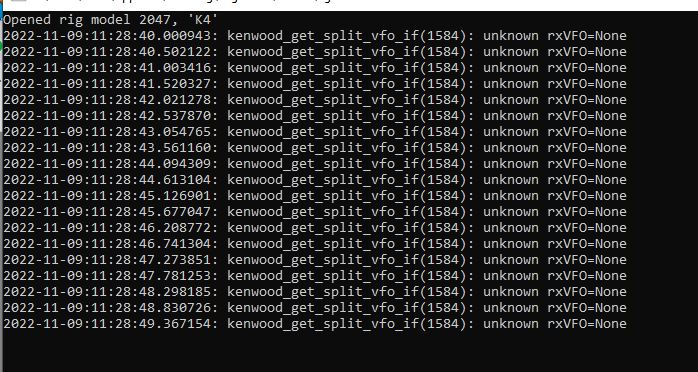

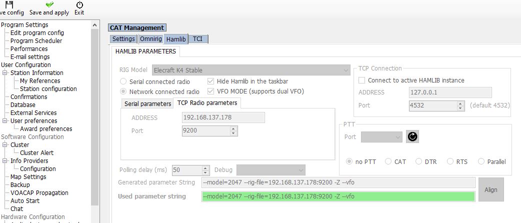

spesso la configurazione CAT , allegata , non rimane memorizzata
capita a qualcuno ?
cosa posso controllare ?
grazie
cc
configurazione CAT
configurazione CAT
- cat.JPG (79.6 KiB) Viewed 12389 times
- cat1 k4.JPG (93.27 KiB) Viewed 12389 times
- cat log k4.JPG (145.38 KiB) Viewed 12389 times

the connection with hamlib in ETH is made
the problem that my log4om does not store the configuration and every time I have to reconfigure
HAM LIB PARAMETERS-NETWORK CONNECTED RADIO-TCP RADIO PARAMETERS
