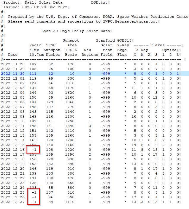

in version 2.23.0.0, my Kp and A were also not displaying correctly (0 and 0 respectively), and neither was my SFI (displaying "-1"). I upgraded to version 2.25.0.0 which now displays Kp to 2 decimal places (1.67) and A = 25. My SFI still displays -1. Sunspot seems correct (96). Any idea what may be wrong? some setting is not correct or something wrong in the software?

Re: SOLAR DATA (K and A) seems not correct since v 2.24.0.0

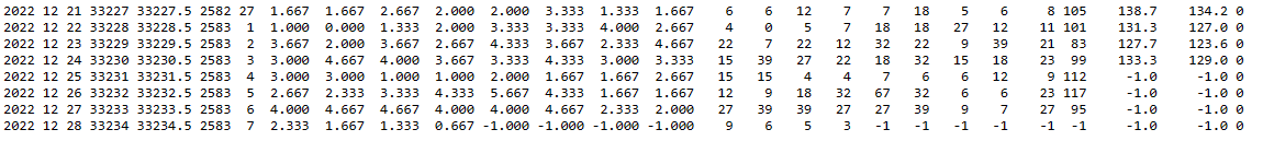

The -1 values are coming from the server its not a Log4OM issue we can only publish what is provided by the space agencies - See below
Chart 1.png (62.08 KiB) Viewed 1610 times
And also from Potsdam
Chart 2.png (20.74 KiB) Viewed 1610 times
K0HD
Posts: 9
Joined: 01 Jul 2020, 16:55
Location: Cannon Falls, MN
Post by K0HD »
Thank you. I understand. Seems strange noaa would publish what is obviously an error. I wonder if anyone at noaa is even paying attention. I found other servers which have more reasonable numbers: solar flux 150 on 12/27/2022.
Thanks for a great product LOG4OM. Helps make ham radio interesting and enjoyable.
We are sure that servers stating 150 for the same period are guessing because there is no source data supporting that number
