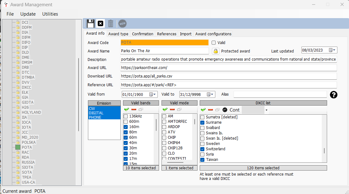

Thanks for your response!!IW3HMH wrote: 06 Mar 2023, 14:21 We updated POTA parks references, please try updating your awards archive from Log4OM menu (Settings -> Update Resources -> Log4OM awards) and check if you can see the references.
I have made the update like you have proposed, but still getting the same result.
On yesterday I made some new POTA's like one of Sweden (SAOTAY) with the same result too. But after the update now I can see that the padlock on the left column has lossed the icon and appear with a blue or grey square without the padlock, but still not let in me store the Sweden assign like the others comented before...
I have updated all the other elements updatables too and closed and launched again Log4OM just in case...
