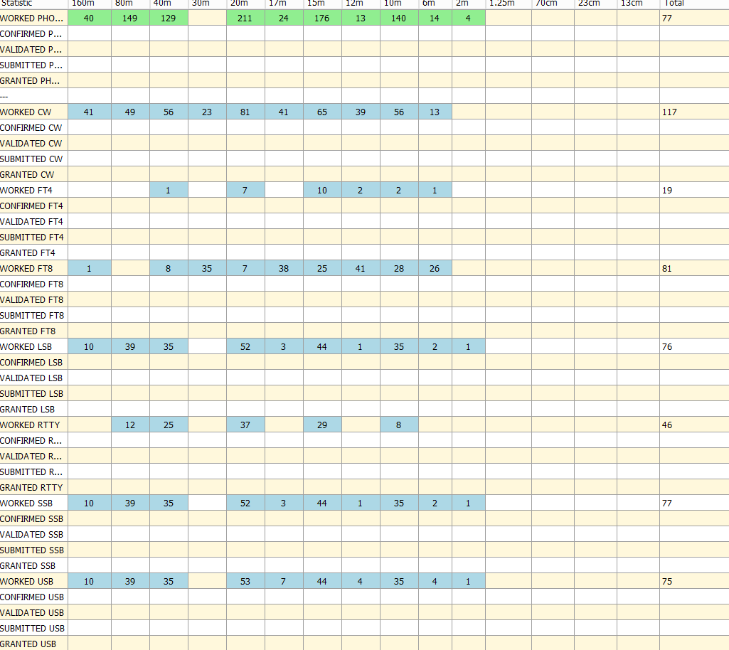

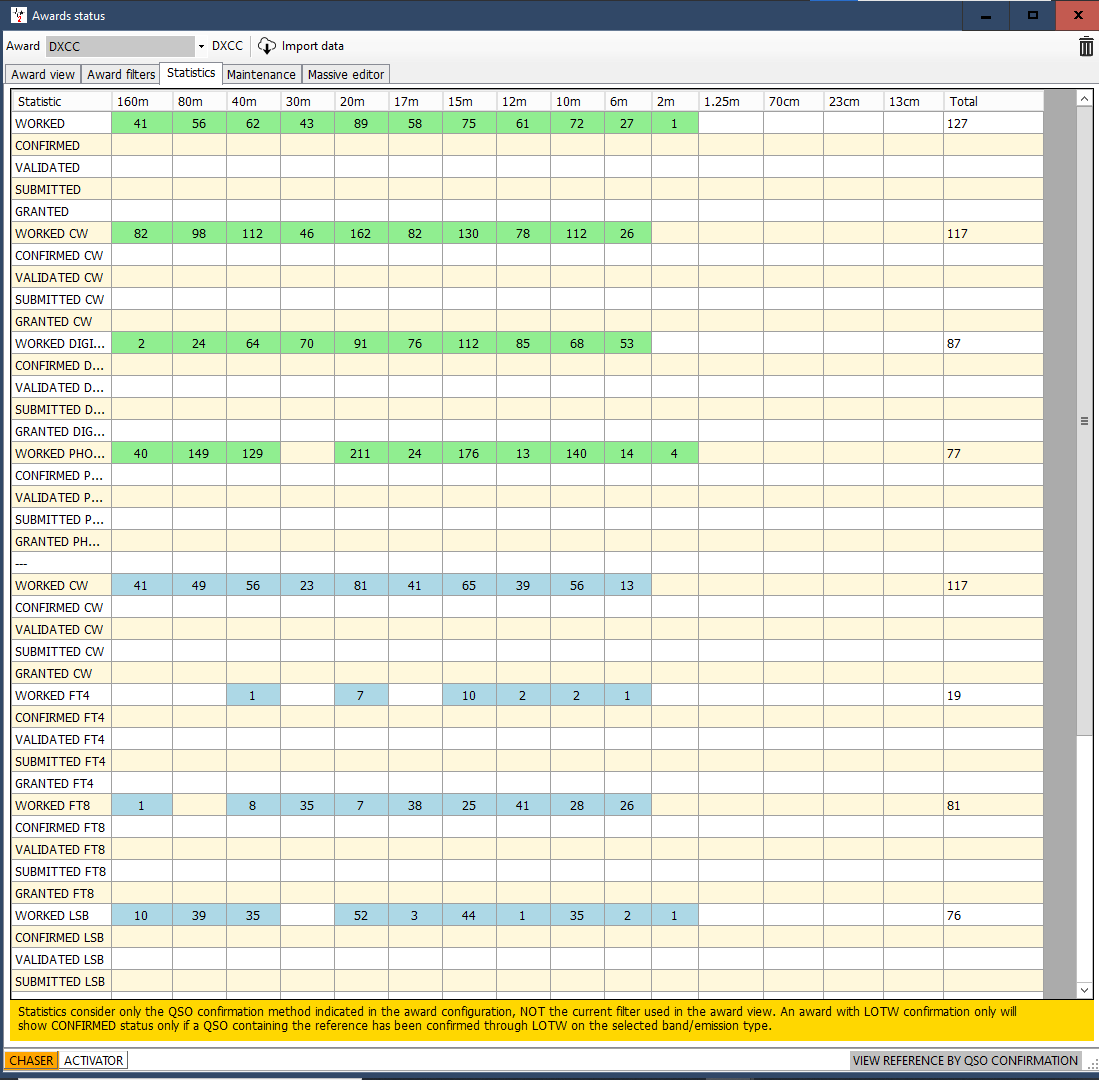

there is (and has been for a while) an error in the band totals shown in green when Award Status Statistics are selected when detailed mode statistics is selected in the opening screen.
The attached screen is from my DXCC award status . The totals in green are incorrectly obtained from the detailed modes shown below.
In the case of CW the figures are simply doubled for each band.
For other modes the totals are also very odd. Digi mode totals do not seem to be correct at all.
I believe the totals shown for the individual mode totals per band shown in Green should remain the same for WORKED, CW, PHone and DIGItal and should remain the same wheter "detailed mode Statistics" is on or off.
The detailed mode stats appear correct except for SSB
I am not sure why I have USB figures for bands where LSB is used or vice versa, that may be due to error on my part or from import from my contest logger N1MM+.

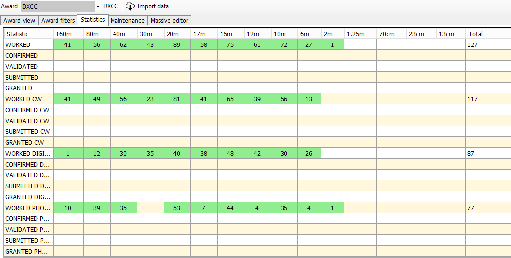

The numbers in the attached screen are for my first years' use of Log4OM. The screen shot attached only covers what I can see on my PC screen so I have included a 2nd screen grab with the detailed modes info too! I also attach a screen grab with detailed mode turned off. These totals are correct.
I believe that totals in green should not change if detailed mod statistics is turned on, they are always the same.
The mode stats seem correct but in my case I seem to have LSB and USB in some odd places probably due to an import error. I will check and try to correct.
Thanks for a really good program, after one year of use I am very pleased and will stick with it.
73 Mike Pemberton G4DDL

Sorry one wrong file attached, sorry.
Mike G4DDL
