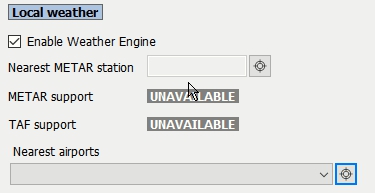

This feature has never worked for me since its introduction. I'm 18 miles or so from YOW (or CYOW), Canada's capital airport.
My location is correct in the station information. No error messages in the log. That said, there sure is a problem. See the attached:
The 'Nearest METAR station' is blank, even after clicking on the location box. The next two lines show UNAVAILBLE. The 'Nearest airports' pull down menu is empty, even after clicking on the location box.
I use Windows 10 and I allow both location access on the PC and allow apps to access my location.

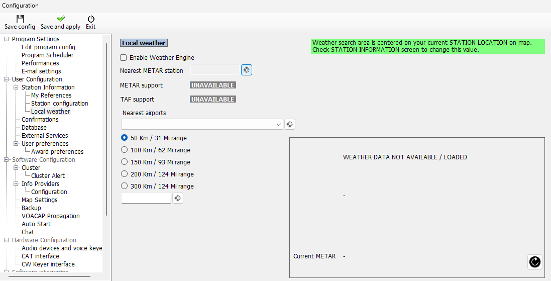

I've re-installed again but no METAR DATA AVAILABLE...
METAR ERROR.png (53.91 KiB) Viewed 4192 times
I have LIRQ Firenze Airport very near... is there something else debug option to set to help in solving problem?

Re: METAR DATA not loaded
In your Screenshot [Enable weather engine] is NOT enabled. If not enabled no METAR Data will be loaded.

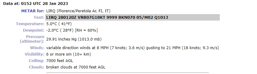

iz5fsa wrote: 27 Jan 2023, 15:07 It's about 3 weeks I have weather enabled, but no METAR it's still answering : METAR data unavailable...
The data is available so it's not a problem on the reporting end.
