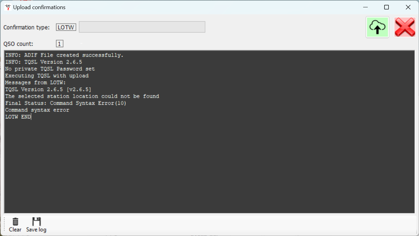

Now to the problem. I just moved my installations over to a new Windows 11 PC, and most things have moved well and are working well. I used the ARRL steps to move the TQSL certificates, etc., to the new machine, and they all look correct when queried from the TQSL forms. However, when I try to upload to LOTW it fails with the message shown in the attached image.
I have double-checked the "station location" in the certificate and it is correct and has not changed. I queried the LOTW help desk and their answer was not helpful, but pointed to Log4OM being a possible problem. I'm sure if it was, there would be many complaining. Does anyone have any idea what this failure points to?

Duane,
With all the APP moves to the new PC with W11 there is some little thing causing the hiccup.
First off make sure your TQSL is working FB. Export an ADIF from Log4OM (I would select for this test about 2 Q's).
Take that exported ADIF and do an upload to LOTW directly via TQSL. See what result you get from that effort.
If good then go back into Log4OM and check out Configuration / External Services / LOTW and make sure everything you have entered there is spotless ;) . IE: Make sure your TQSL and Temporary Paths are exact. Also make sure your Station ID is properly noted ... spelled correctly, uppercase, lowercase, etc., etc..
Doing the test with TQSL first confirms that element is working or not. If it is working then double-down on the entries in Log4OM for LOTW / TQSL.

Thanks, Nolan - excellent suggestion. I had confirmed that the TQSL was working properly on the new PC and thought that when I moved all the settings for Log4OM from the old PC that all settings were set. However, under "User Configuration | External Services | LOTW, the "Station ID" setting was left blank, and should have had the "AC5AA-Home" setting selected. Once I corrected that. all worked fine. Thanks for the pointer! Now it looks like I'd better scan through all the other settings and see if anything else is missing.
