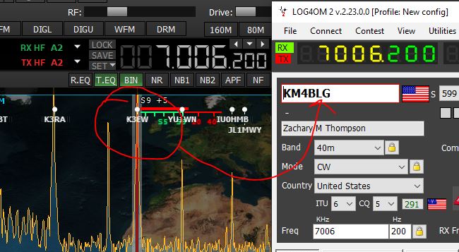

I'm using SDC to "push" spots toward my SDR2X, however, the radio reads FREQ but not "the spot".
I prefer not to have multiple windows set up (band plans cluster etc) when I can operate directly from radio SDR screen.
Which is the suggested course of action to fix this "issue"?

Forget SDC let log4om send the spots to EESDR

Now clicking spot in EESDR spectrum is the same as clicking spot in Log4OM for lookup and freq change, so far better than SDC
I have SunSDR 2 DX also and dont need SDC as an intermediary
