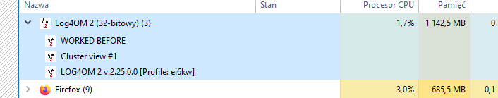

It's much better to do this as cluster filter. Log4OM eats up an incredible amount of RAM anyway.
