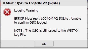

When I complete an FT8 QSO in WSJT-X and log the contact, I get this dialogue panel pop up:
Has anyone any idea how stop the error message from JTAlert, and import the adi file?

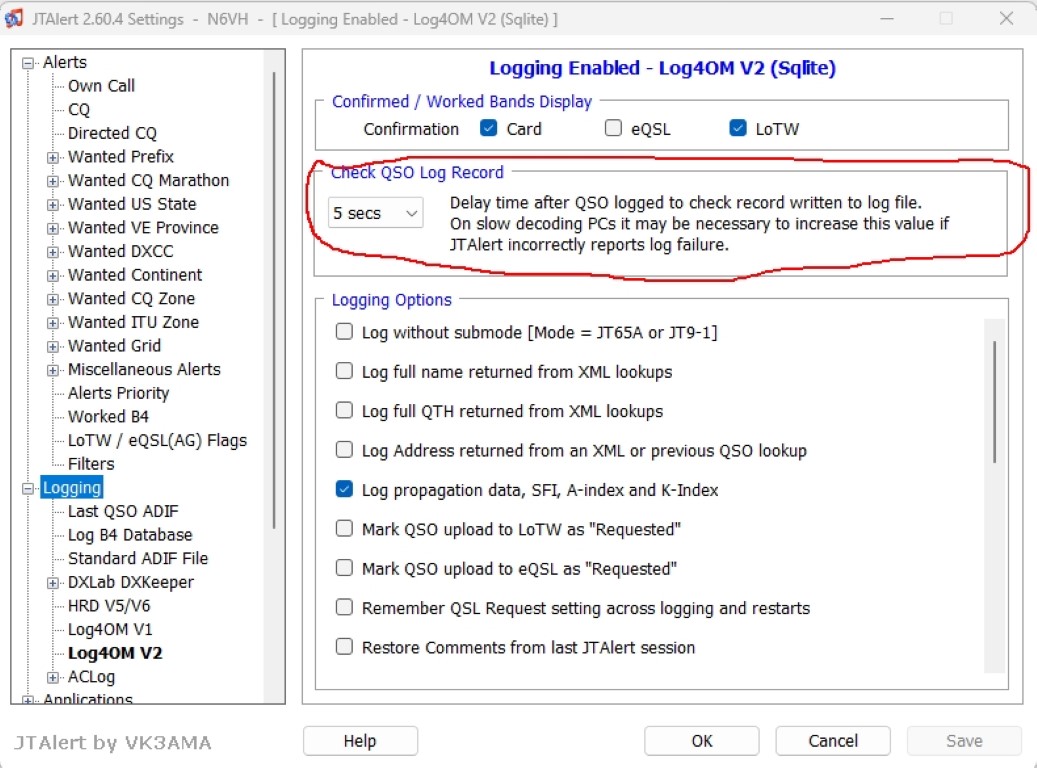

2. There is a setting in WSJT where you can change the interval at which that message apears, try setting it for a longer time
Re: WSJT-X to Log4OM v2 not working
Terry,G4POP wrote: 09 Jan 2023, 12:01 1. The message may not mean the QSO was not logged - check Log4OM and see if the QSO is there
The interval change setting is in JTAlert, not WSJT-X.
Jim N6VH
- JTAlert logging time (Medium).jpg (175.21 KiB) Viewed 2352 times

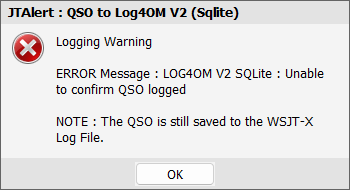

I have a similar problem; I get the same error message but the QSO is not logged. The WSJT log file however imports fine manually.
