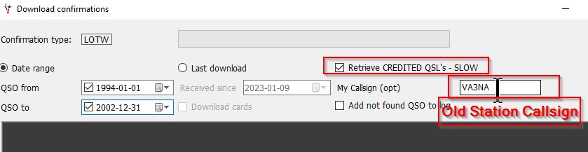

The QSOs in the log have a proper respective station callsign for whatever period such calls were active. LOG4OM will, however, only download granted credits for main station callsign and it will ignore the other (older) station callsign.
Confirmation_download_2023-01-09 21_37_35-Download confirmations.jpg (28.31 KiB) Viewed 1291 times

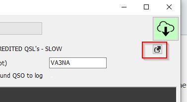

I also tried uploading the ADIF file which I downloaded directly from LOTW and it includes credited contacts.
ADIF_2023-01-09 21_42_43-Log4OM - Post a new topic.jpg (9.26 KiB) Viewed 1291 times
