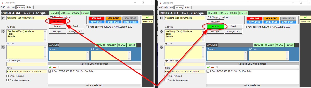

Hello guys
While printing hundreds of QSL's in a single session, it gets unconfortable to click for each single QSO on "Bureau". As default I always find the QSL shipping method on "NO SEND" (see picture in attachment). Is there a way to set "Bureau" as defult?
Label print routing.png (162.48 KiB) Viewed 435 times
Thanks in advance for any answer
Fabio HB9FAP

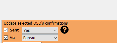

Hi Terry
Thanks for the advise. I tried it but without success. Perhaps I did not understand exactly. What I did, all the QSL I want to print, I have set the status for them on "QSL sent" but it did not change. while trying to process the label print:
QSL sent and via bureau.png (3.78 KiB) Viewed 428 times
Any additional suggestions are very appreciated.
thanks
Fabio HB9FAP
Re: Label print routing How to set "Bureau" as default
Bulk edit in QSO Manager
Page 98>>>> of our user guide
Single field update
Select QSLvia from field list and enter Bureau in New value box
