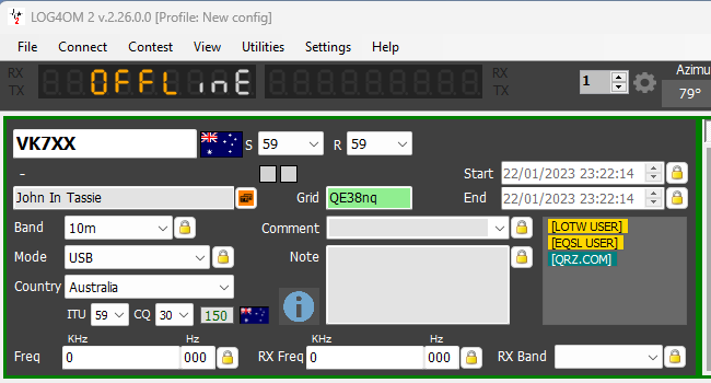

FURTHER INFORMATION BY WAY OF EDIT.... When I type my own callsign in to Log4OM it shows my grid as QE37 which is incorrect, it should be, as is in qrz, QE38. To confirm this bug, I also typed in VK7AC and his grid is also shown incorrectly by Log4OM
EDIT NO 2... I have now reverted back to 2.25.0.0 and edited all todays contacts so that the grids are correct, 2.26.0.0 grids area is a bug for sure
-------------ORIGINAL MESSAGE BELOW ------------------------
I have this morning installed the subject version and immediately noticed that it is no longer displaying nor recording 6 character grids.... All grids are now displaying and recording as only 4 characters.
Personally, I like to record 6 characters for grids....

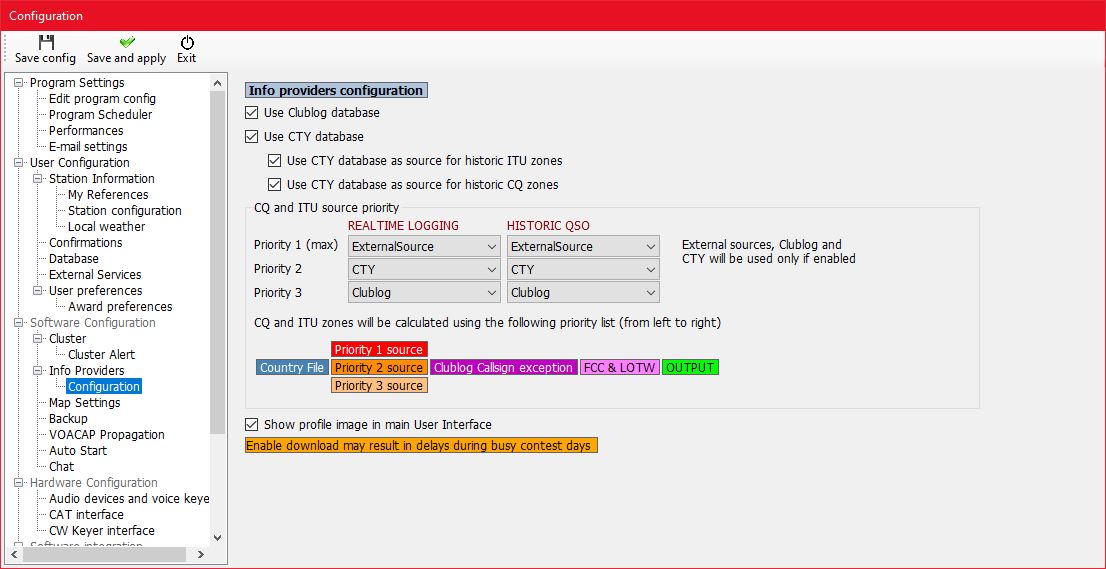

I am running V 2.26.0 and I entered in your call and vk7ac and I got the proper grid IDs.
I've attached my Information Provider arrangement as that can have a play in how that data is recovered.
My External Source is QRZ.com as well.
Try that arrangement and see if that makes any difference.
Also ... make sure you force an update to the Clublog and Country d/b's.

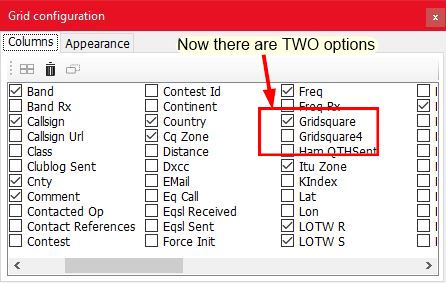

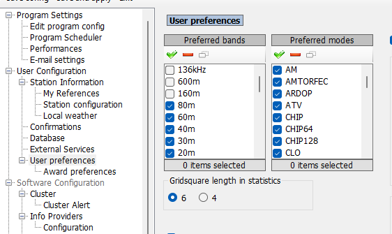

RE: 4 or 6 digit Grid Squares - Did you accidentally change the Gridsquare length at: Configuration / User Preferences ?? Also there are now two options for either a 4 or 6 digit grid square "column" display in your many/various data grids like the Recent QSO (F7) tab. See image below.

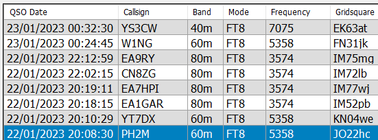

Furder more, I use WSJT-X and Gridtracker and until the 2.25.0.0 version this was working perfect when I log any QSO, but not now.

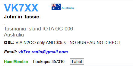

VK7XX wrote: 22 Jan 2023, 19:59 FURTHER INFORMATION BY WAY OF EDIT.... When I type my own callsign in to Log4OM it shows my grid as QE37 which is incorrect, it should be, as is in qrz, QE38. To confirm this bug, I also typed in VK7AC and his grid is also shown incorrectly by Log4OM
John,
Its working fine but I notice your only a 'Ham member' of QRZ not an XML paid subscriber which means that you dont get the locator from QRZ lookup so Log4OM is selecting the 'Country' grig locator

Have you got the setting for 6/4 digit grids set correctly - see below

With all the anterior versions the log from WSJT-X store the 6 caracters that I put on it but not now with the new version, so I think that this is not a problem over the external data downloaded by Log4OM but from the storing process and reading data from logging a QSO from other app...
