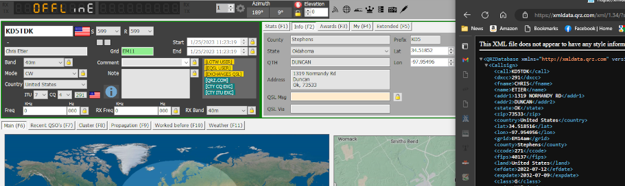

I'm not sure what's causing this, but it seems I've seen Waco Tx a lot when looking up calls on this latest version 2.26.0.0
I'm using QRZ as the primary source, and no secondary.
I can reproduce it with call KD5TDK. In QRZ, he's in EM14am, but when I search for his call in this version, it says EM11.
Grid incorrect causing map to be incorrect

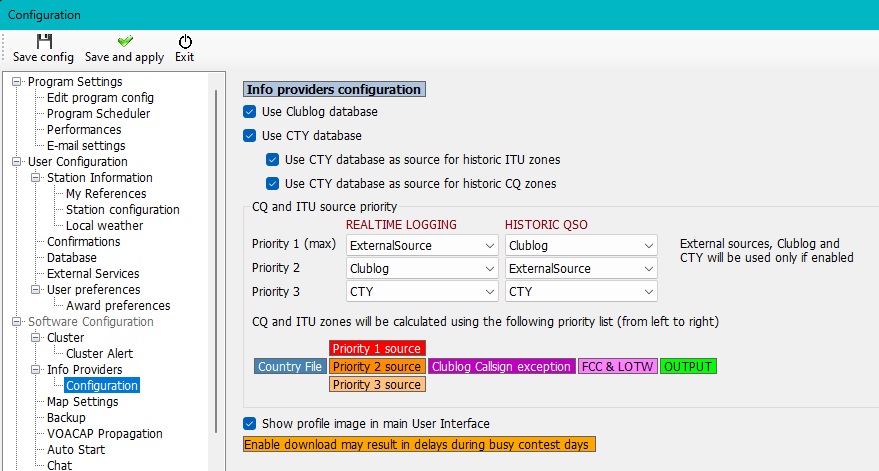

Read through this thread: https://forum.log4om.com/viewtopic.php?t=8096
Look at the screen clips I attached in my reply. Try and set your Information Provider Configuration the same and try those calls again.
Make sure that your Country and Clublog files have also been updated. Settings / Update Resources / Clublog & Country File

I turned up the log level to debug, and get the information below.
If I take the search url, and put that into a new browser tab, the grid info coming back from QRZ is correct (EM14am), but the Grid in on screen is still EM11.

Well the lookup works fine for me, see below
Are you sure that you have the Program config/info providers - Configuration tab set correctly, again as below?

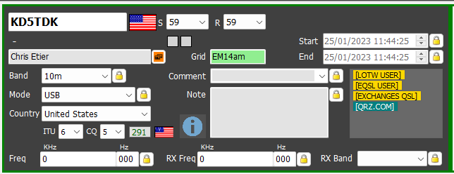

Ok, I have my realtime logging now in the order listed above, and is now picking the correct location.
