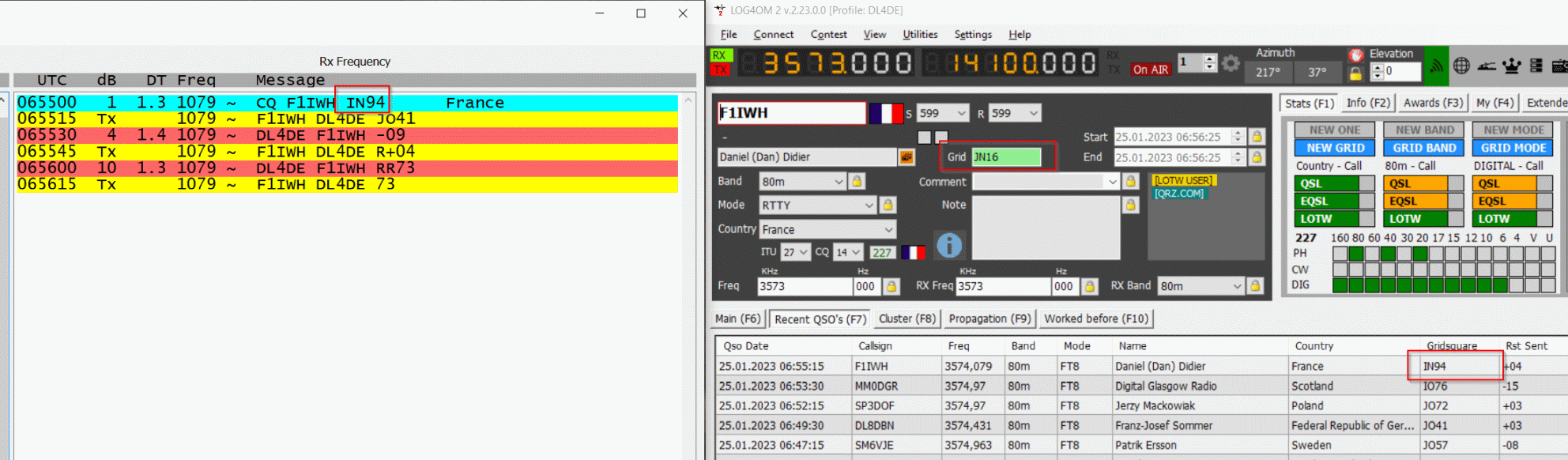

Here is an example:
On the left you see the QSO windows from WSJT-X with the transmitted grid IN94.
Log4OM shows JN16 as the grid and later, when saving the QSO, the grid is set back to IN94 again (see red marks in screenshot).
Other applications like GridTracker show the correct grid.
I have attached my QRZ.com account to Log4OM. I am not a paying user there.
The grid value is showing the correct content there.
Is Log4OM not gettingt the grid together with other data from WSJT-X?
Where does it get this strange grids from?
Thanks for your help. Have a good time!

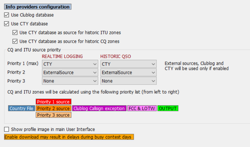

DL4DE wrote: 25 Jan 2023, 14:49 Hello Terry,
what exactly do you mean?
The "Info Providers"?
That is wrong
order for left column should be
External source
Clublog
CTY
For right column shoud be
Clublog
External source
CTY
The graphic at the botton should illustrate the origins and order of the data and if all else fails our user guide explains everything

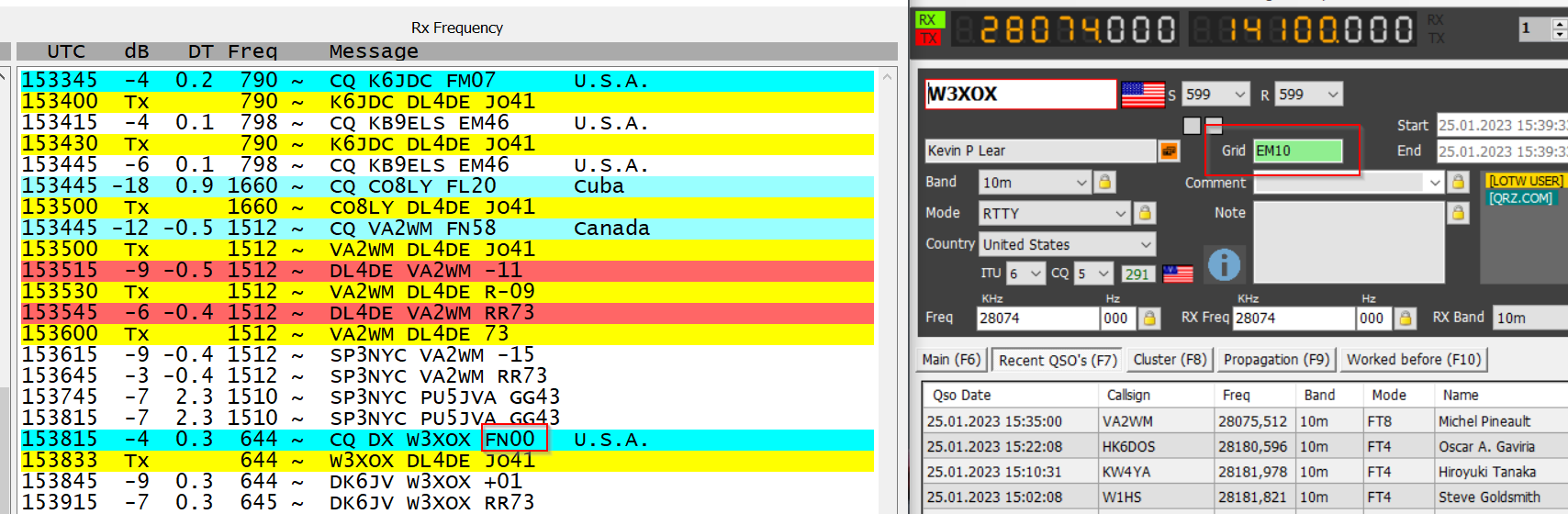

But during the QSO, before the log entry was made, the grid is different in nearly all cases.
W3XOX 's grid is FN00. But somehow from somewhere Log4OM shows EM10. Who is telling the application this wrong data?
I changed the settings like you suggested, but with no difference. The screenshot was made after I changed it.
I still can't understand this behaviour of the software.

1. Probably because either:DL4DE wrote: 25 Jan 2023, 15:44
a. You have not selected the correct settings in the Log4om config as described earlier
b. The FT8 information is wrong
c. The info from QRZ is incorrect
d. The info via the QRZ API for external software is not the same as displayed on their web site - As I said earlier that has been happening for the last 10 years
Most likely is a.above! but what the heck, that grid locator is not being saved to your log its the data from WSJT thats saved!
Contradictory statement - I did not describe the search order as you have it displayedI changed the settings like you suggested, but with no difference. The screenshot was made after I changed it.
Re: Grid incorrect in combination with WSJT-X
The settings from above fixed the wrong GRID lookup on my side, thanks for that
What is still wrong is the retrieved GRID when the logged station is not registered on QRZ.com
I send the GRID that I have received in WSJT-X and stored in the log to Log4OM but there another GRID is shown and saved.
After saving I have to edit the GRID manually but only for contacts that I cannot look up.
So what would be the correct settings for those stations?
My goal would be that all GRIDs were saved from WSJT-X because the GRIDs that are send out are more up to date then from QRZ.com and Co.

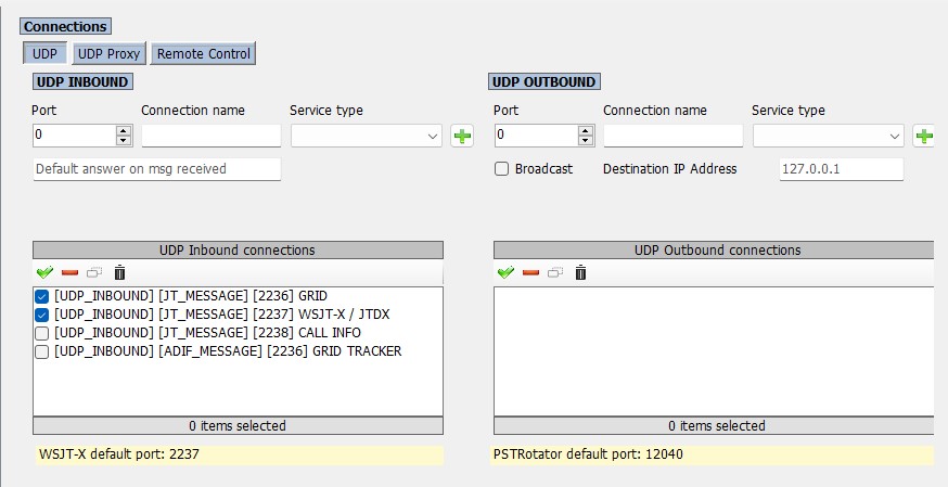

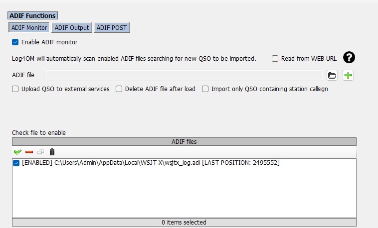

How are the qao's transfered to log4om by ADIF monitor or UDP
please see attached screenshots.
I set the ADIF monitor so that missing QSOs are imported when opening Log4OM.
That is working very well because sometimes I forgot to open Log4OM
In the second screenshot you can see my UDP settings, there is also a connection to GridTracker which is also working very good.
If there are any glitches in the settings please let me know.
wish you all a nice weekend.
73s
