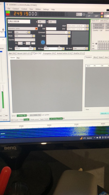

The cluster works but the screen is completely grey
- 95B9AB5F-94EA-4C23-BD12-C1C096EF396F.jpeg (55.52 KiB) Viewed 3230 times

salve
dal log :
023-02-18 12:10:55.5047 INFO: [ClusterManagement] : Connecting cluster(s)...
2023-02-18 12:10:55.5204 ERROR: [ClusterManagement][dje_zZ344DYT9D6HSRVA_ejd] : Error while parsing incoming cluster data
[EXCEPTION] Indice oltre i limiti della matrice. System.IndexOutOfRangeException: Indice oltre i limiti della matrice.
in System.Array.Clear(Array array, Int32 index, Int32 length)
in System.Collections.Generic.Queue`1.Clear()
in L4ONG.BL.Cluster.ClusterManagement.dje_zZ344DYT9D6HSRVA_ejd(ClusterList dje_z84GTWD5DYSYY6CZ_ejd)
2023-02-18 12:10:55.5204 INFO: [ClusterManagement] : Cluster(s) Disconnecting...

Same problem with me:
2023-02-20 12:20:44.7193 INFO: [ClusterManagement] : Connecting cluster(s)...
2023-02-20 12:20:44.7580 ERROR: [ClusterManagement][dje_zZ344DYT9D6HSRVA_ejd] : Error while parsing incoming cluster data
[EXCEPTION] Index was outside the bounds of the array. System.IndexOutOfRangeException: Index was outside the bounds of the array.
at System.Array.Clear(Array array, Int32 index, Int32 length)
at System.Collections.Generic.Queue`1.Clear()
at L4ONG.BL.Cluster.ClusterManagement.dje_zZ344DYT9D6HSRVA_ejd(ClusterList dje_z84GTWD5DYSYY6CZ_ejd)
2023-02-20 12:20:44.7605 INFO: [ClusterManagement] : Cluster(s) Disconnecting...

Have you tried other cluster servers to check that the issue is not with the server your using because I have not received any other reports of this and its working fine here with both the installed version and the portable version on my tablet!
Re: Cluster error vers. 2.26
other connection attempts with other servers are aborted.
you need to restart log4om
