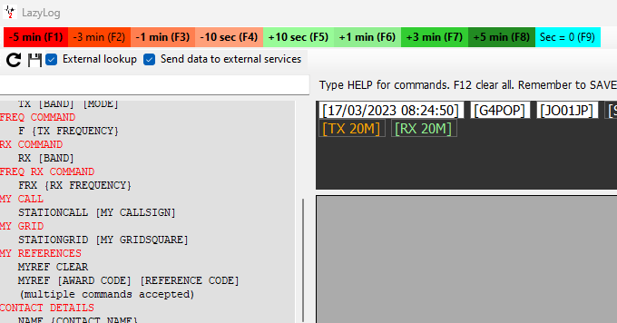

Re: Uploading old QSOs
No, in Lazylog you are able to enter 'My Call', 'My Grid' etc so there is no need to keep changing configs
Screenshot 2023-03-17 082809.png (31.13 KiB) Viewed 1128 times
