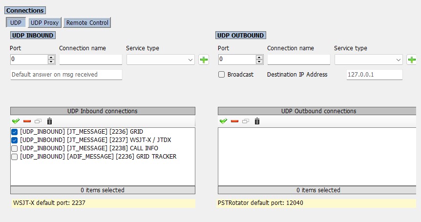

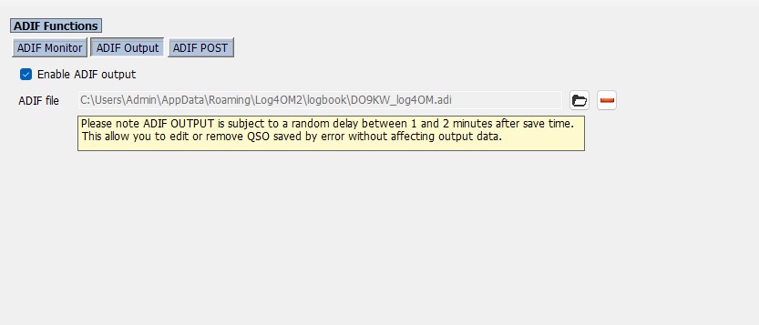

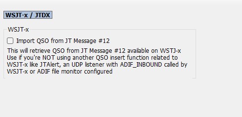

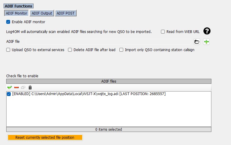

I have attached you some screenshots for the WSJT-X integration.
I removed the setting for WSJT-X - Import QSO from JT Message #12 because I use UDP Listener for the loggings that come directly from WSJT-X and the ADIF monitor for the integration of missing QSOs from the WSJT-X adif if I forget to open Log4OM (which worked without any problems in the past.)

- Screenshot 2023-02-25 001101.jpg (22.7 KiB) Viewed 1182 times
- Screenshot 2023-02-25 001037.jpg (34.85 KiB) Viewed 1182 times
- Screenshot 2023-02-25 001022.jpg (53.14 KiB) Viewed 1182 times
73 Stefan
Re: please help - all my contacts gets duplicated
3 more screenshots.
73s
73s
- Screenshot 2023-02-25 003732.jpg (74 KiB) Viewed 1182 times
- Screenshot 2023-02-25 002640.jpg (68.1 KiB) Viewed 1182 times
- Screenshot 2023-02-25 001150.jpg (32.23 KiB) Viewed 1182 times
73 Stefan
Hi Stefan,
think your problem is the enabled ADIF monitor. In my case it´s off and all is working fine with UDP only. If you have run
ADIF monitor and UDP it could be possible that each contact is stored twice ..... Check out without ADIF monitor enabled
in the configuration settings.
Ok, after reading the User Guide I understand some settings better.
I deactivated the ADIF monitor and deleted the double entries, it took a while but now everything seems to be allright again
BUT:
When I forget to start Log4OM and log a few contacts to my WSJT-X adif file will they be added to Log4OM after opening it?
If not how can I manage this without getting double entries? What would be the best way?
I always thought the ADIF monitor is the right tool for this scenario.
regards
BUT:
regards
