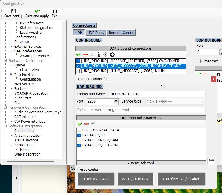

1) we created a single "Incoming JT ADIF" connection of the ADIF_Message type and in the options we selected:
"Upload_QSO and "Update_CQ_ITUZONE"

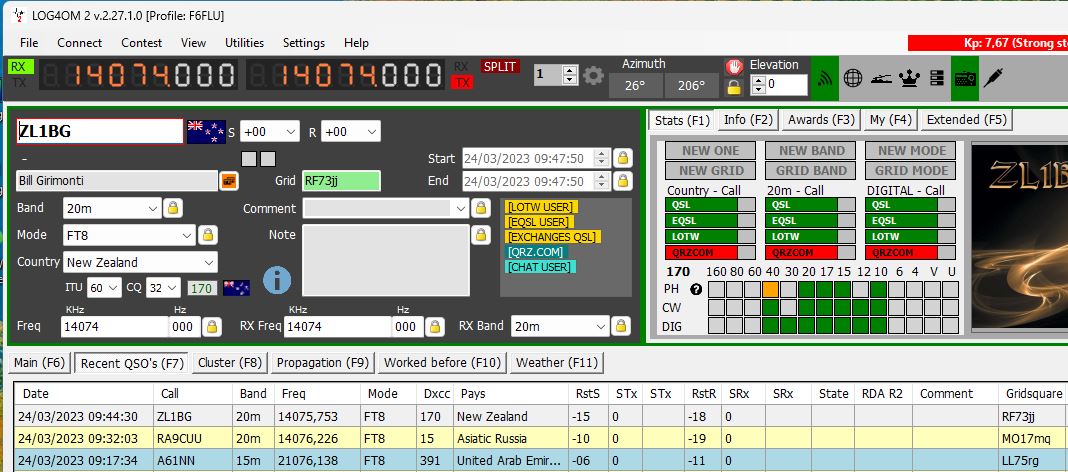

but if you log a QSO from JTDX-JTAlert the gridsquare entered in the JTDX Log window is still modified by Log4OM
For example I contact A61NN whose gridsquare in JTDX is LL75; Log4OM records this QSO with the Gridsquare LL75rg
Same with RA9CUU I force the gridsquare in the Log window of JTDX to MO17 and well Log4om modifies this Gridsquare to MO17mq
There must be another setting somewhere that I forgot?

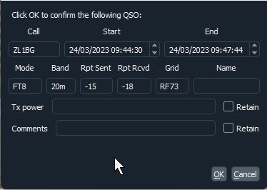

other examples
2023-03-24 10_47_36.jpg (16.2 KiB) Viewed 2054 times
2023-03-24 10_47_51.jpg (132.25 KiB) Viewed 2054 times
2023-03-24 10_50_39.jpg (100.6 KiB) Viewed 2052 times

I had the same issues allthough I re-set the connections, here you can read about my "solution": https://forum.log4om.com/viewtopic.php?t=8257&start=20
In my case the ADIF_MESSAGE was the problem, I changed everything to JT_MESSAGE (as it was in 2.26) and it works again like a charm.
Uploading to external sources, no more empty name fields and 4 digit locator as it comes from WSJT-X instead of the 6 digit locator (that comes from QRZ.com I guess).
I don't know why this works for me but it does :D
