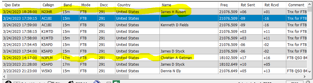

See attachment of my log.
The bottom yellow highlight was before update to 2.27.1 - All is well
The top yellow highlight is after backing down to 2.26.0 - All seems well
In the middle are three contacts. Each one is double posted, missing name field, and not doing log updates to EQSL and QRZ.
I am on latest Windows 10, latest WSJT-X , and JtAlert 2.6.5

Charlie,
When you installed V 2.27.1.0 (you noted all was working well??) Did you note all the settings/port values for your existing UDP Inbound Connections? Did you then fully "delete" them? Did you then create all new UDP Inbound Connections?
Have you looked at this from Terry? https://forum.log4om.com/viewtopic.php?p=43147#p43147
If you have done all of that, I'll be brave and then ask why you went back to an earlier release?

OK I have got 2.27.1 "working".
But here is my concern - I want LOG4OM to work just like it was working before 2.27.1.
What UDP settings should I have set? was gridsquares being updated before? Was CQ values being updated before? Was data being updated from external sources?
I seemed to like everything that was happening before. I had two UDP entries for JTALERT to which I added UPLOAD_QSO to for release 2.27.1. What else do I need, if anything, to get back to the way things were happening before!

Charlie,
You only need one incoming connection to make JTalert log. Just use the preset at the bottom and make sure the port you choose matches your JT program. Use all the default settings. The incoming string has the grid info so you really don't want Log4OM changing that.
I have been testing this for last few weeks and the results are very accurate. The setup process is so simple we assume there is more to it. If you choose to tweak the parameters of your incoming connection you can but I would not recommend you do so.

Rich:
Thank you for your help.
I deleted the JT_Message and the ADIF_message. I then used the JtAlert preset except I changed the port from 2234 to 2235 to match up with JtAlert.
Tested and looks good.
