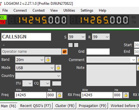

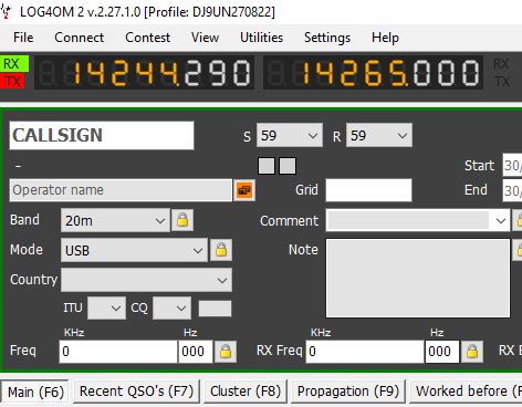

Hello, I have a problem with the Cat connection with the IC 7700 and Log4OM V 2.27.1.0

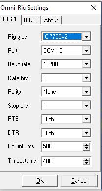

Selecting the tranceiver IC 7700 or IC 7700 v2 or IC 7700v2 Data in omnirig connection is there and all function. However turning the VFO on my Rig the frenquencies remain on top but the small window at the bottom with the frequencies disapears. Do to this this spotting is not working anymore What is wrong please. Connections are made with the RS 232 cable to an Yaesu SCU 17 interface and to the PC with USB. Changing the tranceiver model in the list communication works again, turning the VFO on the rig frequency disapear again

Change Poll interval in Omnirig to minimum which I think is 50 mor 100
