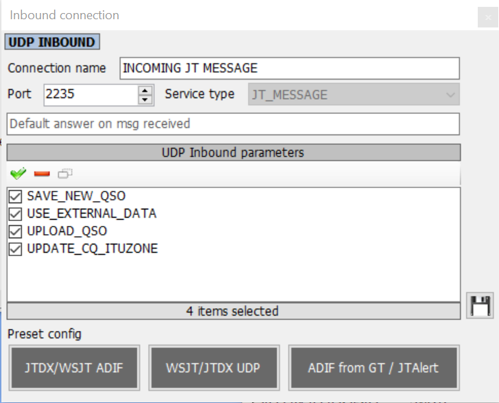

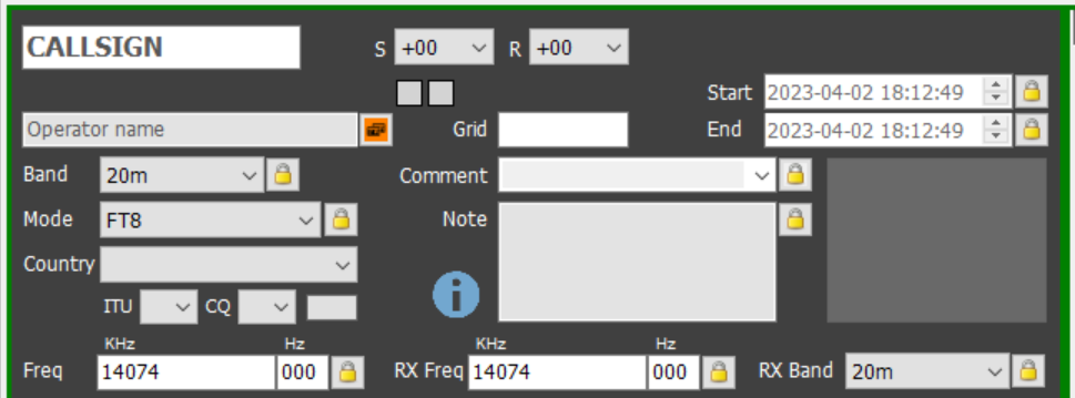

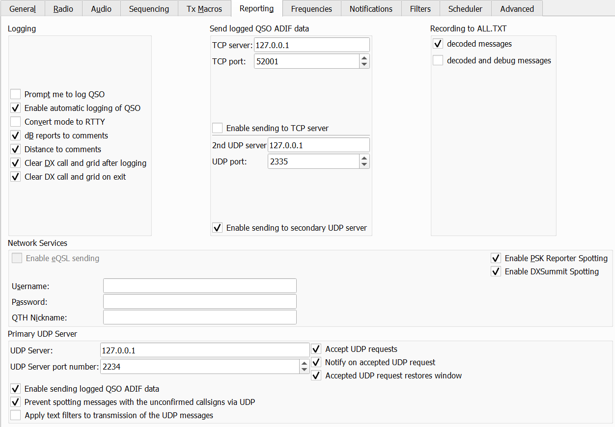

Hi
I have been trying to get my Callsign lookup to auto populate from JTDX. JTDX is able to send the ADIF log and I am logging from JTDX into Log4OM without any issues. However, the "Callsign" field just below the frequency does not populate. I have tried many combinations without success. Both applications are running on the same computer. A fellow ham and I went through his settings VS mine (his works) we had no joy. Please see screen shots below for current settings. (they only work for logging)
Log4OM Version: v.2.27.1.0
JTDX Version: v2.2.159-32A
log4om call.PNG (65.15 KiB) Viewed 432 times
jtdx report.PNG (56.92 KiB) Viewed 432 times

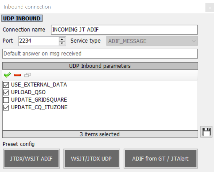

Please see for 2 more images of settings. System would only allow me to post 3 in the original.
jt message.PNG (73.73 KiB) Viewed 431 times
jt adif.PNG (72.67 KiB) Viewed 431 times

Well after searching the forums again, I was able to find this:
https://forum.log4om.com/viewtopic.php?t=8257&start=20
Following what was done there I am able to solve my problem.

VA7RU wrote: 02 Apr 2023, 18:33 Well after searching the forums again, I was able to find this:
Tim,
Also well documented in the Release Notes for the new release as well as in the "current" User Guide.
Glad you got it sorted.
