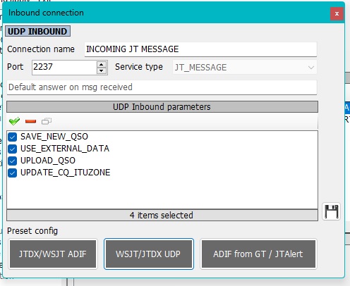

this weekend I'm traveling to a radio amateur friend to install Log4om latest version, we installed the Beta version 2.27.1.2
The use is simple JTDX direct to Log4OM
We followed the usual guidelines, deletion of old connections, reboot, creation of a new ADIF MESSAGE connection (port 2237 here), backup and PC reboot. if we validate a QSO from JTDX it is well logged in Log4OM
BUT
the call is not transmitted in Log4OM, that is to say that when the in clicks on a call in JTDX normally the call is transmitted in Log4OM and we can for example see if we have already made QSO or not (with the window worked before) but there the call is not transmitted
In the documentation it is shown that it is necessary to validate in second UDP the port 2333 (for example) what I did but that does not change anything

Dan,
Start again and use the WSJT/JTDX UDP connection not the ADIF one
Screenshot 2023-04-07 113006.png (42.2 KiB) Viewed 2413 times
This worked fine on my test set up although I dont use those modes myself

thank you Terry I did exactly as you showed me on your screenshots with the same port numbers and it works fine now

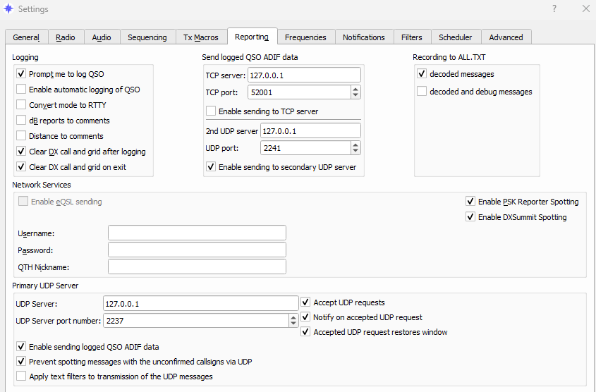

It really is detailed as Nolan suggested in the user guide so it has to be a missmatch of ports
Perhaps you can post screen shots of the following, as I said before I dont use these modes and it would require me to install all of the software again and do a fresh set up :(
1. Log4OM UDP outbound connections window
2. JTDX reporting window
3. JTALert/logging/Log4OM V2 window
4. JTALert/Applications/WSJT-JTDX window
We should then be able to spot your issue
